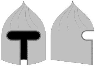

Well I played with several different designs and finally decided on the features I liked. I used Paint, because as I said, I can't draw.
So here's a sketch of the helmet I'd like.
Posted: Fri Dec 18, 2009 2:43 am
by Sasha_Khan
That's going to be a lot of time, money and/or effort on something you may regret later.
WHY do you want to integrate features from wildly dissimilar helms?
A mantra often repeated here - "Just because you CAN do something, doesn't mean you SHOULD..."

Maybe he is thinking about a Gondorian helmet...
Posted: Fri Dec 18, 2009 7:38 am
by AriAnson
The fallacy here is that if A is historical and B is historical, then A and B together are historical. Helmets generally had very specific shapes according to region and time period. I certainly understand when we add features to a helm to attempt to make them SCA-legal, but the change proposed by the original poster is completely aesthetic.
The problem with the Persian helm is that it requires heavy modification to be SCA-legal, requiring big pieces to be added on, anyway. A bunch of grill bars aren't any less distracting than a barbute-face on a conical helm, but the barbute-face does have one problem - you lose the Persianness of the helm altogether. It would just look like a pointy barbute, as if it were made by an armorer who only had a vague idea of how to make that style of helmet.
Custom helms and prototype patterns are generally more expensive than off-the-shelf products or patterns that are fully developed. If you're an expert armorer, go ahead and make it. If not, prepare to pay out the nose for someone skilled enough to turn a simple drawing into reality.

Somewhere I think I have seen a faceted (think fluted) barbute like helmet, 15th century time frame. It had very eastern european influences. Maybe Master Magnus will chime in on this one. Or some of the czec armourers.
Posted: Fri Dec 18, 2009 10:59 am
by Donngal
Halbrust,
Are you gonna make this yourself?
What you designed in the drawing is pretty simple, in a drawing. I would say to make in metal and no experience is gonna be very difficult and frustrating.
Then when you consider for SCA you really dont want anything less than 14 ga.
As far as combining helmets, its your helm do what you want. For sca fighting as long as its safe. To me its no different then fighting in white sneakers.
I suggest that you compromise with your self. If its the Persian style top you like and the tight face of the barbute then maybe go for the Persian with a tight face opening, or even a nasal that drops down covering part of the face.
Also maybe do some more research around Eastern helms. I think if your looking for acceptance combining two helms from the same region with similar styles is better off.

by schreiber
AriAnson wrote:The fallacy here is that if A is historical and B is historical, then A and B together are historical.
This.
There's a concept in logic called the principle of noncontradiction.
It states basically that something can not both be a thing and not be a thing.
So replace "something" with "helmet" and "thing" with "historical".
A helmet can not both be historical and not historical.
If it's not historical, there will be people in the SCA who will notice, even if you started with two different helms. But OTOH every single helm on the SCA field of combat has historical anomalies to it. If you really want to get down to it, you would need to bloom your own iron for it to be a true repro.
Everyone draws the line somewhere. Most here on AA draw the line farther on the historical side of the spectrum than the great unwashed masses of the SCA do. There is a rule about approximating pre 1600 gear, but there's no rule against mix-and-match, and the guys who insist on being Kurgan from Highlander are never corrected.
If it is mostly historical but has never been done before or is not widely known through the usual books (doubtful) then you should know everything you can know about it and the people who ask about it on the field will get some free education, and will be grateful.
But I'm going to echo Donngal as well... start hitting some metal with some hammers and then scale back your expectations. Lots of folks here have been doing this for decades and have never attempted an onion top.
Posted: Fri Dec 18, 2009 2:28 pm
by Thorsteinn Raudskeggr
Halbrust wrote:So here's a sketch of the helmet I'd like.
That's nifty. If you've got the cash and a dream then go for it. I can't afford the one I really want to do some day (I figure it'll be like $2000) but when I can get an aventail for mine then I'll still be pretty happy.

Yep, you are contemplating a spun-top. This is a helmet in two halves, upper and lower: a circular-section top half which may be gotten in a pointed, rounded-conical bullet shape as well as a hemispherical configuration. Metal Spinning is a forming technique, and has been used to make helmet tops. Barring the spiral fluting you'd like -- and you may need to wait for fluting until you've got that kind of money, while a simpler smooth configuration may be doable right now -- they look exactly like your drawing, right down to being fat side to side, compared with the human head inside them. This is why I mentioned ovalization in the post you found baffling -- squashing the form of the thing into something more conforming with the oval shape of the human head.
The lower half of these helmets is a skirt of sheet metal going around as far as required. With your design, there will be bars inserted to make your helmet openings narrow enough to be legal. Which SCA Kingdom is yours, again? -- the Kingdom site will have its Weapons and Armour Standards page for the aid of local Marshallates, and this page will have your Kingdom's specs on the max dimensions of the holes in your helmet. Your design tells me need to get familiar with these. Barest minimum, you are going to have a crossbar joining the two corners just at the cross of your T face, and another crossbar at the very bottom of the T. More probably, you will also have a bar horizontally across the eyes and a vertical bar dividing the vertical stroke of your T: these bars would form a T themselves. Slanty diagonal bars also work if you don't mind looking a bit like a bridge warning sign, those black and yellow things with the diagonal striping. The "sight" or eyeslit part of the T should be quite long, as you will desire peripheral vision; it is likely your present design is a little short in the sights, so don't be afraid to stretch it some left to right. This helps compensate for one SCA helmet problem: its tendency to muffle your hearing. (which is curable, but let's save it for later)
Now we turn to what's needed to make one: a shop. You need to get access to one, and it has to have the tools to work metal. Most American saw-and-hammer guys are working in wood. Metalwork in the home is rarer, much rarer than hobby auto mechanicking. An anvil won't be all that necessary to armorsmithing, but several hammers, a means of cutting metal by saber saw or bench shear, a means of making holes like a R-W #5 Jr. metal punch or an electric drill and bits. A stout workbench will make all your tasks easier, is made of wood and nails, and may be the FIRST project you undertake. It need not be large -- 36"x36" will do. If you expect to be moving around for the forseeable future -- as a young man, I wasn't any too geographically stable myself; got all the way around the world in segments, been in or through every time zone there is one way or another -- make it demountable for convenient moving, with detachable yet stout legs.
A lot of SCAdians make a little armor from time to time in their garages. Pal around with these guys and pick their brains. What experience with working metal do you presently have?
