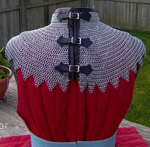

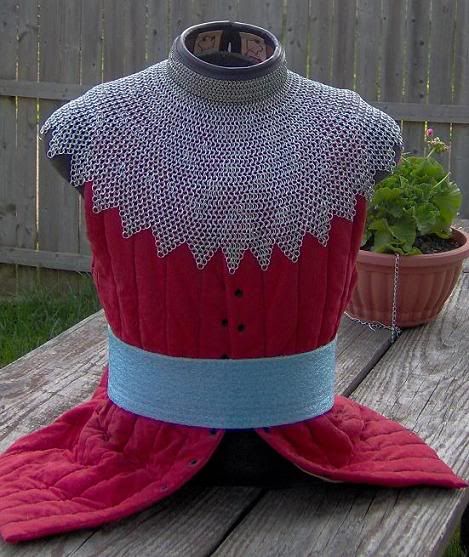

You know what
Im doing the same thing. However I changed my mind 100% when I feel in love with something else.
Finding a pattern like that will not be easy. Your best bet is to follow the Onlinearmor.com website and start with everything made of fabric and remember to give extra length to everything so you can use pins to connect it.
I was running though my mind of what I wanted to make it out of. Leather looks to crappy and cant take a hit unless its backed up by steel and that would have to be hidden or else you may look like a stormtrooper.
So nahh that looked to gay.
Plate doesn't flow however it is solid. Making it articulated has its up's. Then I kept looking.
HA! chain maile! I then found this and fell in love.
Currently, I'm using galvanized steel. Even better was I bought a Coif off Budk.com for 20 bucks and that way All I have to do is take it apart and reassemble it. Im about 1/4 finished and Its been about 4 to 5 hours of work so far.
