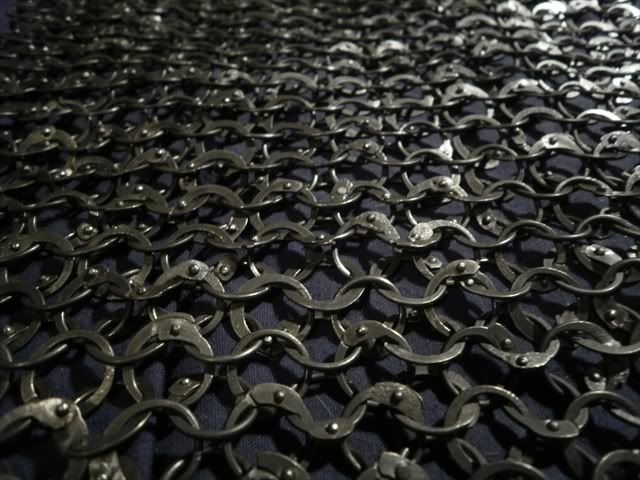

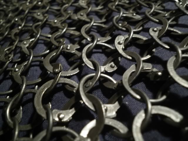

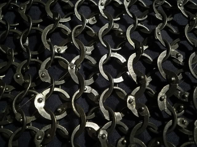

Alright, It's been a couple weeks, but I've finally got some pics and some progress.
first off, here's the tools I'm using.
the knockoff whitney has a 1/16" bit in it. I'm planning on buying a couple more to experiment with making a drift to pierce rings instead of punching them.
The set tongs started out as a pair of carpenters nippers, and the piston is made from a big ass brake caliper and a couple chunks of steel I scrounged up. The mandrell is a roller off a garage door.
Here's a couple pictures of what I'm turning out. So far I've made about a square foot in the last week and a half or so. I'm glad I'm only making half length sleeves and not a whole shirt.
