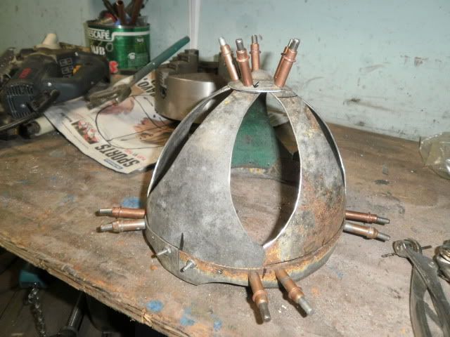

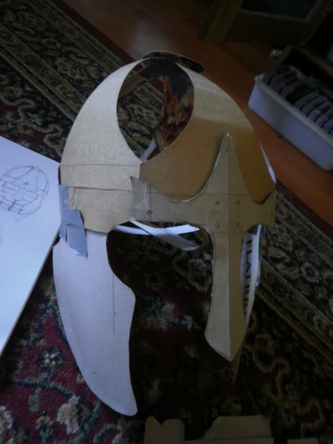

A while back I asked a couple questions about head sizes for some starving student sale helmets I was wanting to make.
Well, today I got a start on the first one. I think it's going pretty good so far. What do you think?
The bands are all being burnished right now. Tomorrow morning they should be ready to assemble, then I'll be able to pattern out the panels. Hopefully by tomorrow evening I'll have the rest of the helm cut, shaped and ready to burnish over night. then on Friday I'm hoping to assemble the rest and start on the bar grill.
Oh, also I REALLY need to get myself some more Colecos, or at least more than 2 tiny bolts.

Looks like you have a pretty cool layout there! i can't wait to see more!!

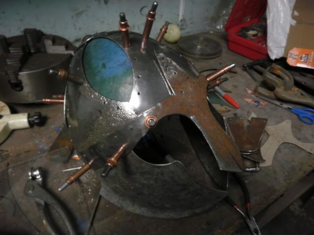

Today I got the panels, cheek plates, nasal, and slats for the back all cut and shaped. They're getting shined up overnight, and tomorrow I plan on assembling everything but the nasal, then starting on the bar grill.

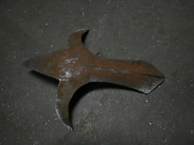

I'm still trying to decide whether or not to try and chisel some eyebrows into the nasal. Anyone have any advice on that?

If I were going to do eyebrows on it, I would raise a lighter sheet and make then on that and then rivet it onto the piece onto the assembly, but that's just to give the detail more depth and if it gets smashed hard enough a replacement would be easy to make as opposed trying to fix it on the nasal... but that's just my 2 cents...
Halberds
Posts: 20444
Location: Republic of Texas
Post by Halberds »
I like to use a dull chisel into a tin/lead block.
Helm is comming along nice.
Thanks for the progress pics.
