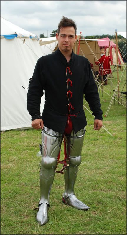

Posted: Wed Apr 21, 2010 8:15 pm
by Pitbull Armory
Hi Guillaume, Nice legs there, those are free floating at the greave and demi greave like I was talking about, I love that setup. Now if I could just learn to shape my legs that nice! Thanks for the pics.
Take care
Pitbull
Posted: Wed Apr 21, 2010 8:59 pm
by Baron Alcyoneus
Aaron, they also did not always wear greaves in the 15th&16thC.
Sometimes they just wore tall boots for lower leg protection, and this worked to pad the knees as well.
In which case, you'd much rather have a demi-greave than just the lower lame.

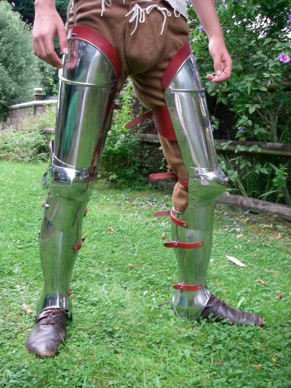

Posted: Thu Apr 22, 2010 1:43 am
by mrks
hi there
very nice legs.
sport ;) attachment works great for the sca. the knee pad is the strap and the leg floats on the elastic.
demigrieve is strapped to the grieve and floas slightly during motion.
real armour wasnt designed to be fought from the knees and in my opinion jumping around like a jackrabbit while kneeling requires a different hanging system.
works great of you dont mind it not being period.
<table><tr><td><a href="http://picasaweb.google.com/lh/photo/a217I0c7Pdf1WUOSXaCOPg?feat=embedwebsite"><img src="http://lh4.ggpht.com/_xijnVOFwTh4/S76T7VJ4Q7I/AAAAAAAAAvk/fu7Re2akKqQ/s400/IMG_6510.JPG"></a></td></tr><tr><td>From <a href="http://picasaweb.google.com/sirmrks/TiGrieves?feat=embedwebsite">Ti grieves</a></td></tr></table>
<table><tr><td><a href="http://picasaweb.google.com/lh/photo/YSR2zmNC50IJ1Ux7HmkaGw?feat=embedwebsite"><img src="http://lh3.ggpht.com/_xijnVOFwTh4/S76T9reGQ7I/AAAAAAAAAv0/sZJoYs-4DtA/s400/IMG_6513.JPG"></a></td></tr><tr><td>From <a href="http://picasaweb.google.com/sirmrks/TiGrieves?feat=embedwebsite">Ti grieves</a></td></tr></table>

Posted: Thu Apr 22, 2010 5:49 pm
by zachos
My leg armour:
Has a pin in the side of the greave, which allows a nice little bit of lateral bend in the knee, so I can wrap my legs nicely round a horse that little bit more. I've never had any problems with them.
As for the reason, I would imagine it would help somewhat in stopping your leg from overextending. You don't want to break your knee or rip ligaments etc, and having the whole lot connected would prevent that a lot better than a floating arrangement.
