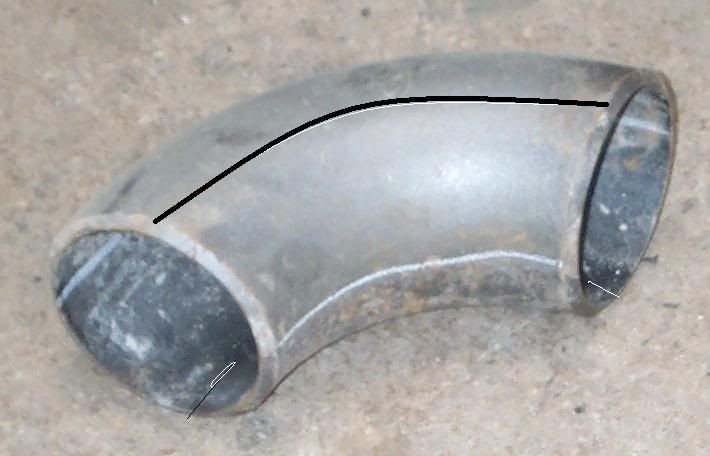

was just looking at some large weld elbows for steel pipe ( 4 1/2" OD and 1/4" thick ) and I thought they could be used for making interesting shapes
cutting it along the chalk marks to make 2 tools from one fitting you would have the choice of the curves on the outside or inside or the pipe and the outside or inside of the bend.
can the hive mind here think of good uses for this.
also cutting it the other way on the black line to make a saddle and a hump.
what is useful for more things?
if it seems like a good idea I will make one up and see if it sells at the next event

The inside of the elbow looks like a good anticlastic forming stake
Cal-

Here's my takes on the pipe stake:
It is a good cheap way to get some useful curves. I have yet to try using the inside surface though. You'd need a pretty big pipe for it to be useful for most stuff, I think.

well it is 4" inside and I have seen bigger but not bothered with them until now.
will cut up one each way

I think the Y-stake is useful.
I use it on sabatons and greaves.
I might sell one or two a year.
I don't know about cutting one up like you have sketched.
I have not had a need for such a stake.
My stakes are made to suit my needs as an armourer.
I usually make tools to fit under or over the metal we wish to shape.
However... your hammer choice is very important to the successful use of said tools.

I dont have the skills needed to work on armour or other sheet metalwork, normally 3mm / 1/8" is the thinnest I work with so the answers I get here help me a lot.
I often start making something out of things I find or have laying around and if people here like them I put them on sale, if they sell I make more.
this bend is plenty big enough to cut which will make twice as many tools, also there are 3 possibilities of external tools and 3 internal tools from it.
I dont know how many of those 6 items will be useful but we will see
