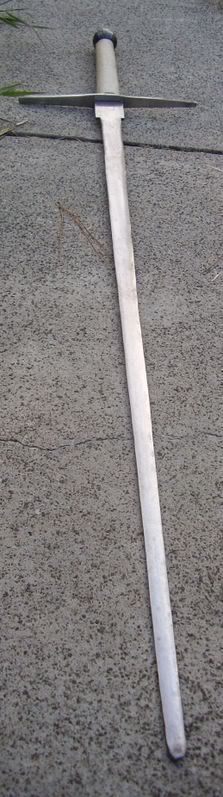

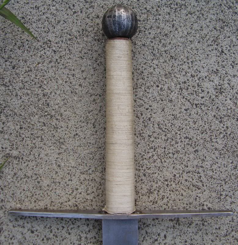

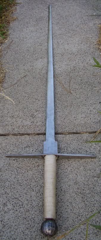

Posted: Wed Sep 29, 2010 3:03 pm
by Aussie Yeoman
If you have lots of time, and patience, you could do what I did.
Go to a commercial spring maker and ask for some already hardened and tempered barstock, that it still flat. I got some fot $15/metre(40").
With a few cutting discs and a helluva lot of time, I had myself a longsword:
It's been going strong for about three years nowin some pretty fierce WMA practice.
I got the pommel from a decorative fencing place that sold all sorts of cast objects.
