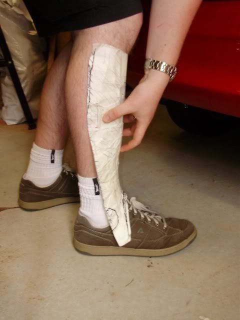

Koops, a couple of suggestions:
The rear half of full greaves does not butt up against the front piece. There is significant overlap. So having 'extra' on the outside is a Good Thing. In fact, having a little extra around the edges is a Good Thing for all armour.
Don't look to a pattern for something as unique as a greave. Rather, you should look at the unique leg you have to fit.
How so?
Have the subject wear the leggings they will wear in combat. Wrap their leg in cling-wrap, then use a non-stretch tape to cover more than the greave will cover, being careful to avoid wrinkles and kinks in the tape.
Using a felt marker mark the ankle bumps and significant anticlastic curves and bits to be especiall dished. Mark in the seams and cut along them. Flatten them out as much as you can, trace it onto paper, then add a margin for safety.
There you have it.
These pics aren't quite up to snuff, but you get the idea. When they're actually *on* the leg the seams are straight and vertical.
I plan on making these in the same fashion as those in the thread by Jiri.
Dave
How so?
There you have it.
