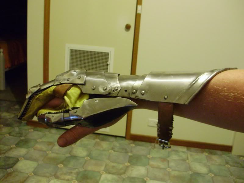

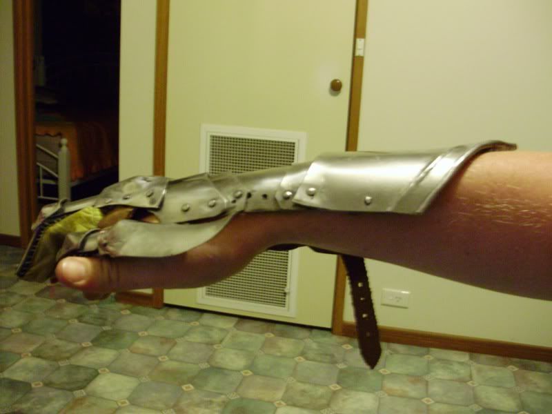

Here's a thread I wrote about the making of mine:
http://forums.armourarchive.org/phpBB2/ ... highlight=
and a couple of pics, though I imagine they might not be all that helpful:
It might help you greatly to make a template from stiff cardboard.
To help with the ulna problem: cut an oval of thick cardboard, with large and small axes of 6 and 3 inches respectively. Line up the piece of cardboard so the long axis is across your wrist, the short axis splits your wrist in half, and the end of your ulna is under the long axis line.
With a finger of your other hand, press on the long axis line until your finger is right on you ulna bump and the cardboard disc seems to balance on this point. Mark that location. That will be where you push the metal out to make the ulna spike.
Without knowing more about what you're particularly having trouble with, I don't know what else to say.

Can you share some previous examples so we can see what's going on?

@ Aussie Yeoman -actually, that was EXACTLY what I was looking for! I would like to see just the different pieces on the hand one by one so that I can get a measure of scale of each piece.
