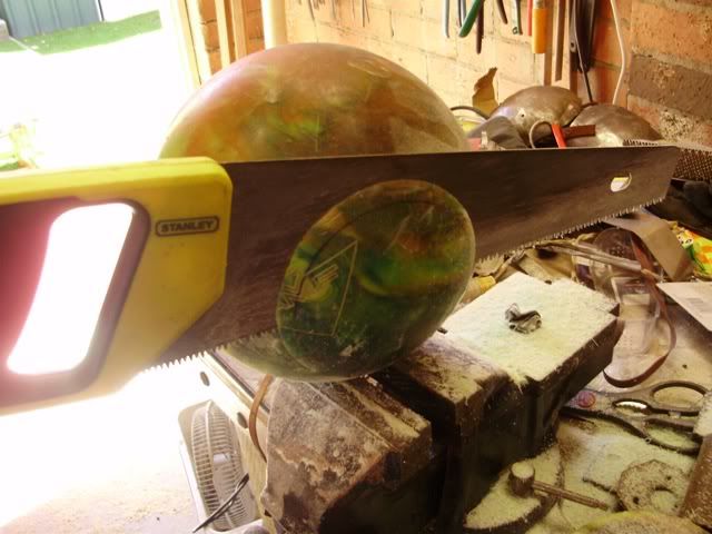

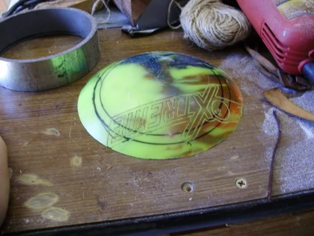

Hey, that's MY ball-hammer and harness!
A few notes on that bowling ball:
The bungee is a strip of inner tube about an inch to an inch and a half wide, tied to a roof rafter.
The ball has a woode handle epoxied into the thumb hole. This is for one handed use, not two handed, gorilla like use. You will still need to hold the piece of armour with the other hand.
When positioning the ball's height, I adjusted it so the ball hovered at rest about 4 inches above the metal surface.
The full breastplate took about three hours, with no planishing at all whatsoever. With a deeper dish, or a large steel ball instead, helm halves should be pretty quick too.
I don't know about cutting one on a bandsaw, but I cut a couple of chunks off of it for fly press dies:
