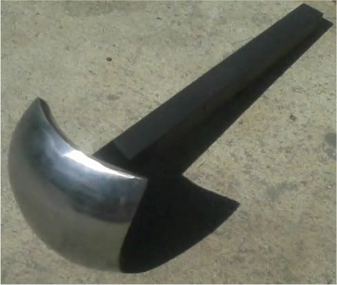

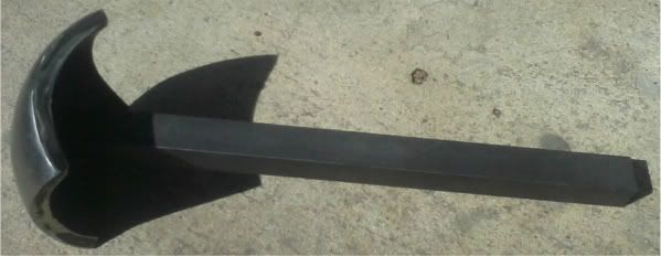

Today i finished up my new sort of mushroom stake. its made out of 1/2" thick hot rolled mild steel which is 5" by 5" square. I heated it up in the forge and dished it with the powered hammer then i welded a 15" long piece of square bar to it. I like the corners on it so i think i will leave them on,if i find i need one thats round then i will make another out of a circle of flat stock. I also popped the tire on my powered hammer while i was doin this which i knew was gonna happen soon then i burned out my angled grinder trying to clean it up,what a day.

That is a thing of beauty!

thanks,now that i have a access to a forge daily i can make all kinds of things.

Yes a fine looking tool.
Thanks for the pics.
