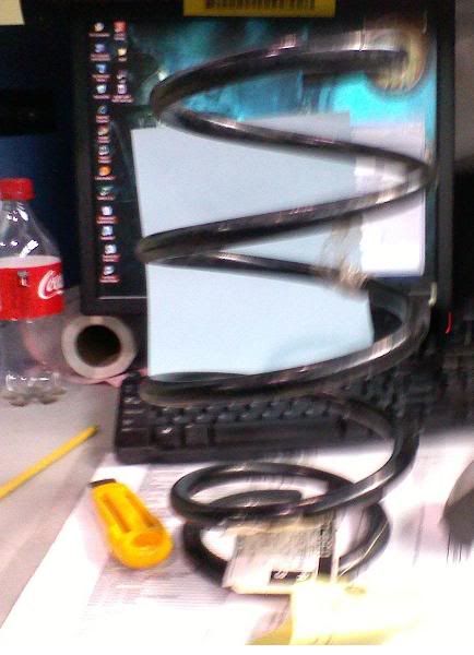

I've got a couple truck springs that I'm wondering
if there is a chance they could be useful material for
smithing....or if I should just pitch them into the
metal recycling bin.....
( sorry about the blurry photo )
What kind of steel might ( I understand it would be a guess )
they be and what kinds of things could I make from them?

The last time I forged anything out of that kind of spring, it took all day for 2 of us to do anything useful with it. I'd say that it's possible that we spent more in fuel dealing with it than if we'd just bought flat or round stock to begin with.
It it's a used spring, you're taking you're chances on it being any good. Usually, used springs are thrown out for a reason.
Used to be that those sorts of springs were 5160, which is pretty decent stuff, and rather forgiving to heat treat. These days, it might be something else.

Usually they are ok for strikers and simple tools but the stock may have stress fractures and without knowing the heattreat temps it's really a shot In the dark for much else.

from springs like that I have seen made eating knives, hook knives for wood carving and lots more.
we just cut off 6" with a grinder, get it hot and straighten it, takes only a few mins to do that and then you can work on it to make what you want.
I would not use it for making a weapon you were going to use but I would use it to make tools with

What could happen if I used a 'used' spring?
Could a small piece be turned into a striker for a flint fire starter kit?
There is more material here than in the file I wasted last time I tried to
make one..... :oops:

The problem with any used spring is that after thousands and thousands of compressions, they tend to develop micro cracks in the cementite/austentite structure.
What that means is that as you heat it up to red-red/orange and begin to squish it out, you are adding more stress and exploiting the weakness. Nothing as frustrating as spending a bunch of time & fuel on a piece that goes *SNAP* while its being worked or after you finish it.
Don't treat it as useless though! just don't rely on it for important projects.
Now you CAN compensate for potential issues in this material in several ways.
First is always work it orange-yellow or hotter, just sub welding temperatures OR
Actually use it to create forge welded stock. A round spring, drawn straight then paired with other material and "hot braided", forge welded, possibly folded and then triple normalized should give you no issues with the material because it has gone to a state of full dissolution when it achieved welding heats.

Truck springs = 5160 most likely.
Plenty of good steel there.
I have two of them sitting in my pile of random stock.
Fished them out of the recycle bin before they could be shipped to China.
I wouldnt make a show knife out of it, 5160 used in springs has (generally) a lower degree of QA and tends to have some large inclusions that can ruin your day if you have spent a large block of time making something pretty and discover the fault as you are grinding.
But for camp knives, punches, chisels etc the steel should be just fine.
5160 is tough as hell. Look up the heat treat recommendations on it and you will be in great shape.
