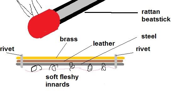

In the pictured scenario, how does the brass fare?
Don't ask me why I had to sketch this in paint to visualize it. Then I just added some tags because this is easier than explaining it.

Exactly as well as the steel.
So, probably, pretty well.

About what I figured but I wanted to see if there was some factor I had missed.

It'll be heavier.

Not looking to use a lot of brass, just some for looks, but always with a steel plate for backing.

The real protection is the hardened leather and padding, not the brass.

yeah as long as the backing is strong you are good.
