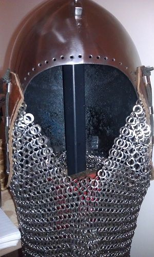

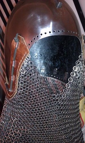

Re: attaching an aventail?
I've included two quick photos of how the welded stainless aventail is attached to my new bascinet. These photos and Konstantin's text should give you a pretty good handle on how to trim the mail. Note the "grain" of the mail in the front.
Basically, you take a trapezoid out of the back and take a rectangle out of the front. Stretch the top of the two triangles you are left with to either side and stitch the whole thing to your leather strap.

Konstantin the Red
- Posts: 26713
And dammit, I don't think my advice is going to really work. The doglegs for his temple triangles are so short they're more cheek triangles. There's no scope there to do that back-tipping number I was talking about and Adamo's pictures show the result of. See how Adamo's triangles go way up higher than yours, Ots? And do you see how his linkrows are gently bent upwards, and how tightly the forward edges of the triangles, right there along the V line, are pulled, and the comparative relaxation of the mail farther back in the triangles -- easiest to see in the front view?
And there was room on the helmet to do that, too -- I was assuming the doglegs went up that far. The visor won't give a lot of trouble, for it is a center-hinge. Temple-hinged ones would take some more bother to not jam on tall temple triangles. We're gonna need to re-think some. I'd've liked three more inches' height to each dogleg, getting the camail strap ends up to where the face opening starts to curve over. That is a sweet basc indeed, all vervelles included and drilled for sewing in a period cloth liner!
So would your visor, on and closed, have trouble fitting with taller triangles? Bargrills at least can be easily adjusted to make more room with a little bending.
I'd've said, "Hey, can't I have some more vervelles going up either side? Why did you quit so low, and not stretch those three out farther up, straddling that chinstrap rivet right there? Something to do with how the visor sits?" (Doing this would mean either cutting out another camail strap -- it can be constructed of more than one piece of leather -- or sewing new, longer doglegs onto the present strap.)
Had those three vervelles been spaced out along the strap doglegs the same spacing the others are on the main strap body, your doglegs would have come out at least two inches taller, and gotten a lot closer to being workable the way I was talking about. At worst, you might have wanted to add four vervelles more, total. Maybe as few as two, or none.
