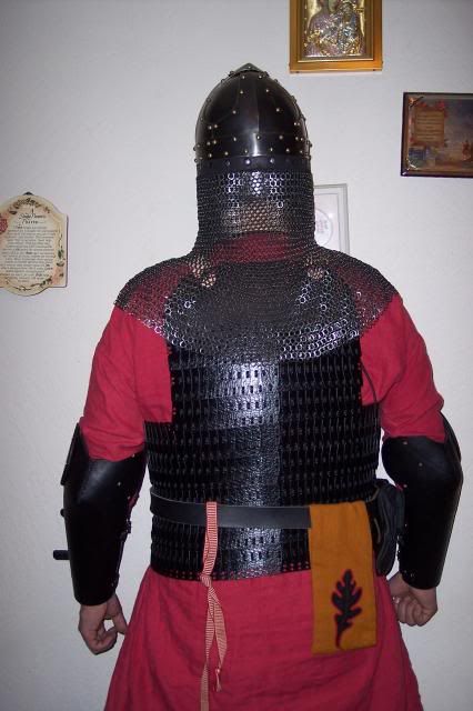

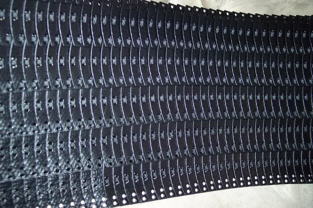

Sorry, the camera I normally use to snap shots is having a fit. I have the back piece and four chest/abdomen rows completed. I'm a very small, skinny guy by S.C.A. heavy list standards(6'3", 235lbs.) So each main row consists of 92 D scales and one center scale. I've been averaging only one main row a day but more can be done at once, I'm sure. Plasticlamellar.com has a disclaimer about these scales which pretty much states that padding is required when using the Wisby D plates and I have to agree. I will have hidden stainless protection over my ribs. I will be wearing a Zoombang shirt underneath as well. The bigger, heavier scales might fare better as main torso protection and, luckily for me I only ever planned on using these for the "look". If I can get my camera running and Photobucket cooperating I will post pics!
Re: Lamellar construction
Posted: Thu Apr 04, 2013 7:02 pm
by Sevastian

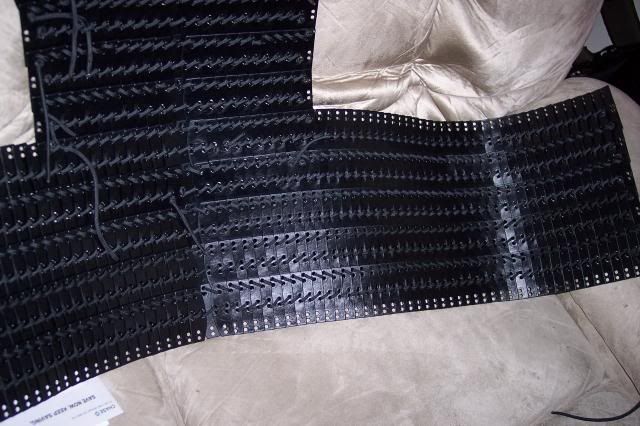

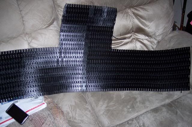

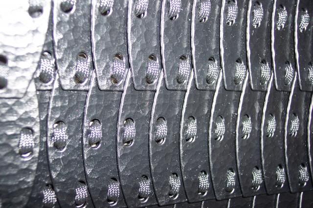

Well the camera is behaving, so here goes:
I may need to remove the top two rows on the back\/
I experimented with puting the rows together like this\/, It proved to be a big pain and seems like it would be more difficult to repair.
Now I need to get to work on the leather pieces. I may need to wait for payday for the extra hardware-brass rings, etc.

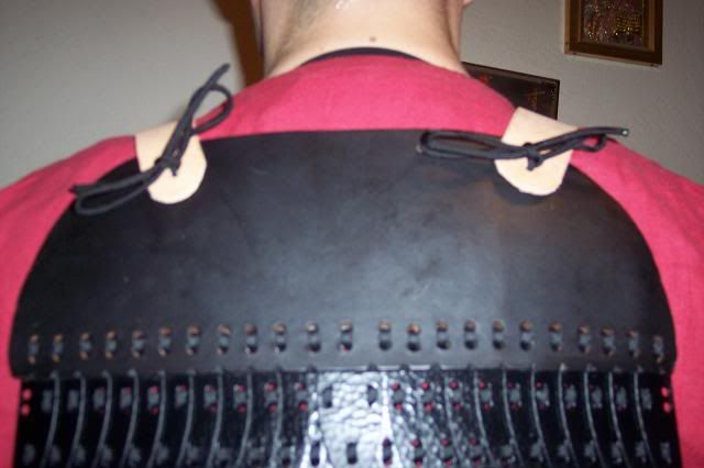

Posted: Sat Apr 06, 2013 10:55 pm

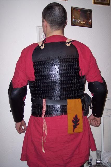

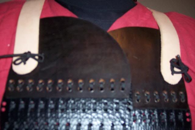

by Sevastian

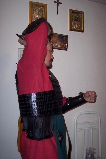

Not much progress to report, sorry. I managed to make the hardened leather upper for the back and lace the front pieces. I hope to make templates for the hardened leather uppers for the front soon. I'd really like to use lacing for everything but I may make a nod to modern technology and use speed rivets to attach the straps for the closures. I can already tell this won't be my last lamellar project, though-its actually quite fun! I'll snap some pics when I make more progress. Just for giggles I put on my Zoombang shirt, tunic and the lamellar over everything and "wrapped" myself a few times. Granted, these weren't Ducal-level but there were no broken plates and it didn't feel terrible. Subjective, I know but promising.

by Sevastian

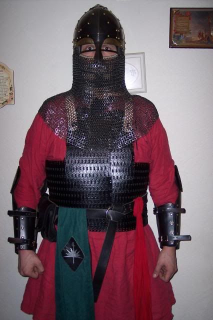

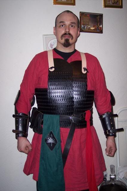

More pics. I will dye the shoulder straps-just not sure what color yet and, yes thats the belt I nomally wear fencing. I do not have a gorget on in the pics with my helmet on. So far I'm happy with how it looks and feels. Now to start on the trim, upper arm pieces and the hip protectors. The closure buckles aren't installed yet, either.
