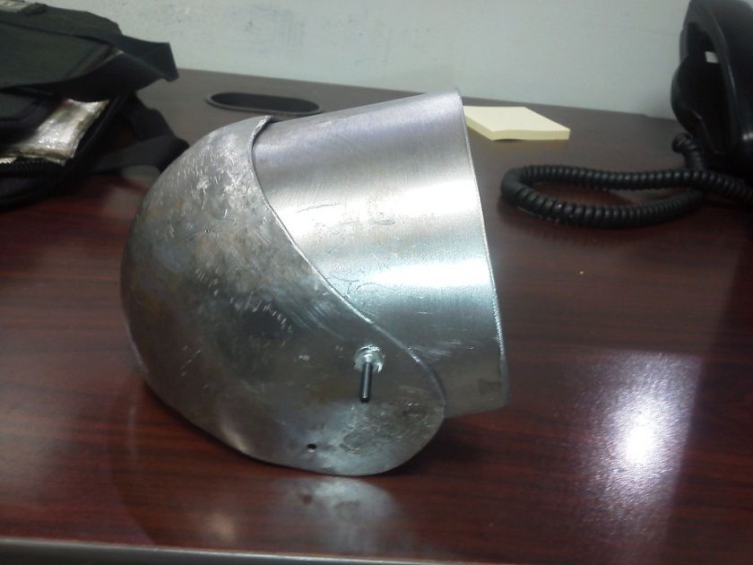

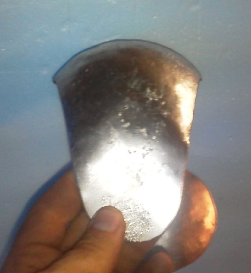

i ment that to read, i took a claw hammer and turnied it into a ball pien hammer for my rivets and forming. also i think i finaly got the first cop ready for planishing what do you guys think?
Re: my first leather armor
Posted: Thu Aug 08, 2013 11:16 am
Looks good. Not as deep as some, but might be deep enough.

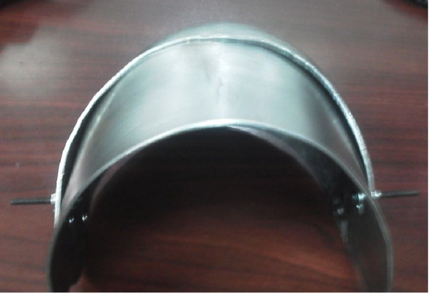

well i have the first lame fitted and articulating smoothly how does it look?
Posted: Fri Aug 09, 2013 4:11 pm
All right so far.
Dish. You won't need a lot. With a slight dish, the lames ride together neatly in flexure.
