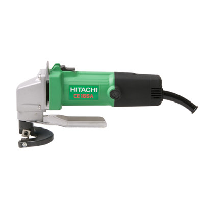

One you do that's still handy and doesn't cost quite as much as a Beverly bench shear is the electric power shear. It's built to work a lot like a big, beefy saber saw, but its blades are different: they push a sturdy edge up and down, shearing against a bottom blade too. An excellent tool for cutting an entire 4'x8' sheet of steel into manageable pieces, say two feet wide by four. Cuts curves too. SCA armoring guys should get the big expensive model that has the power to shear 10 gauge.
