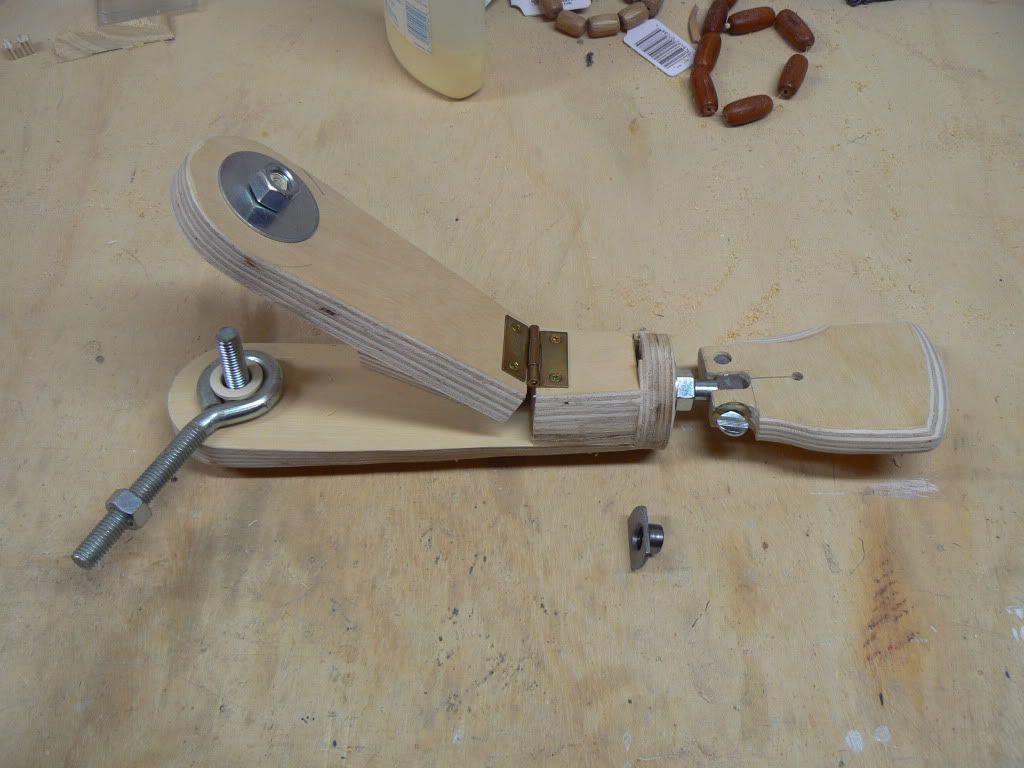

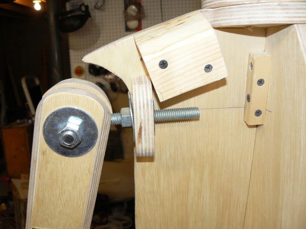

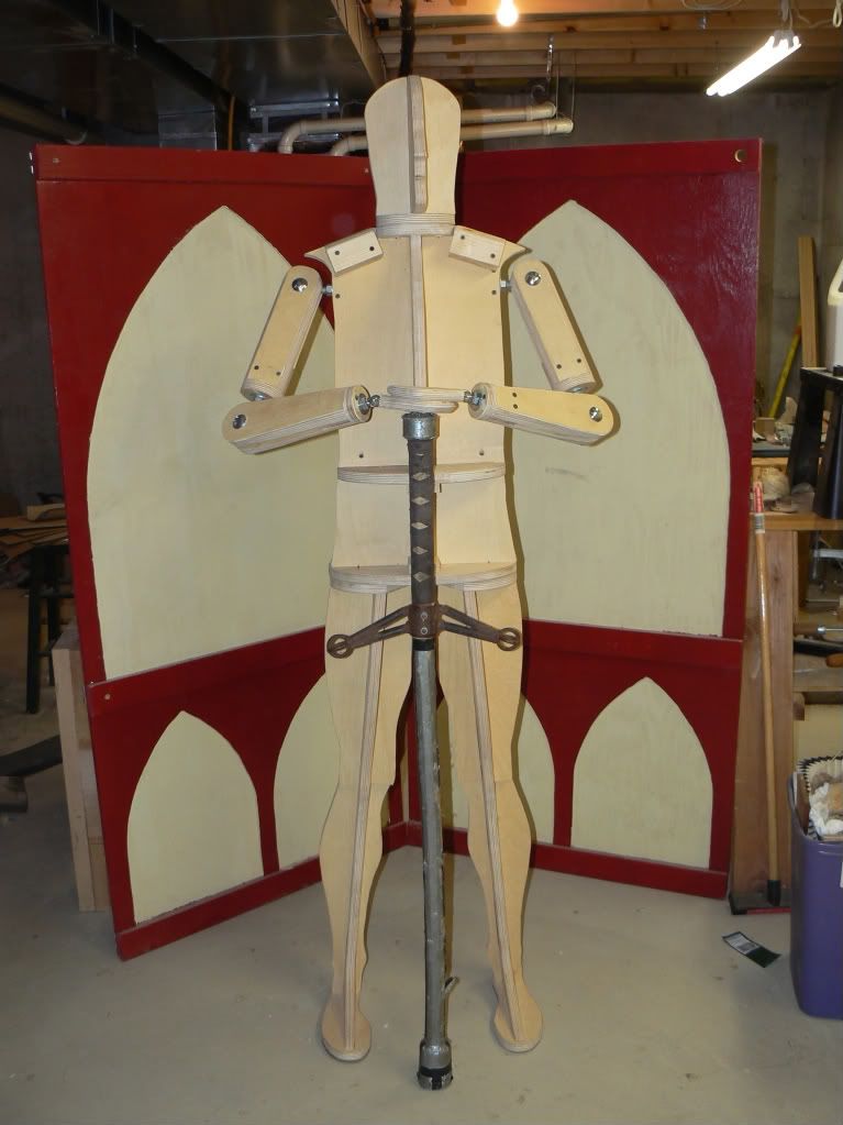

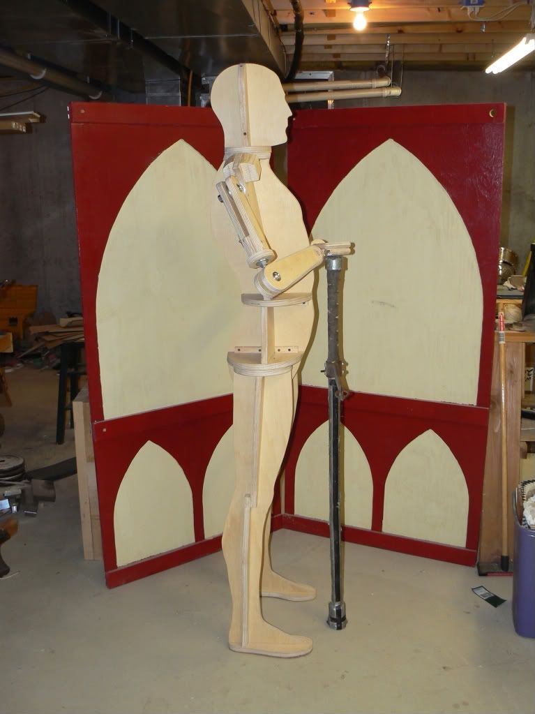

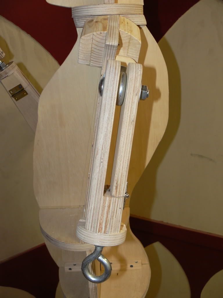

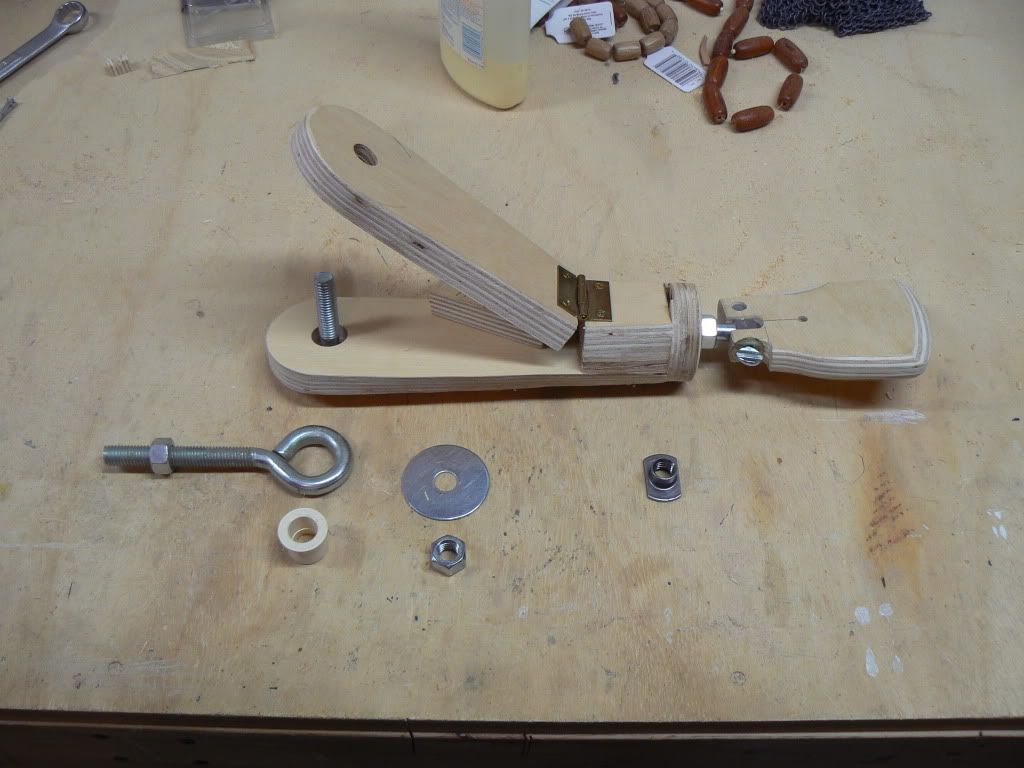

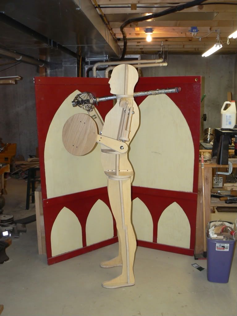

Fabric sewing dummies come in many different styles. The cheaper home-use ones have plastic with some rac and pinnion gears to adjust for a range of sizes. You would think would be the best but leave areas where no pin will stick and frequently it's the seam line. The more profesional versions are foam over a metal rod to aproximate a size and then padding is added in specific spaces to match a customer. That also means profesionals have a size 0, 2, 4, 6, 8, 10, 12, 14 & 16 in their shop and some times the odd sizes too. None of them however are designed to support the weight of armor and most don't go past mid-thigh with a central pole rather then 2 for legs.
I did build one out of plywood for my knight but it was rather tedious and time consuming. Joints are a PITA. If you have a roll-size plotter and pictures from front and side it is a good start. I used pictures from a human anatomy book, photocopied onto graph paper to get a scale and then rescaled in the computer to the right height. It wasn't perfect but it worked well enough. As a benefit to a plywood version, you can drill holes and lace arming points directly to the manequin rather then using a foundation garment (which will not fit well and will stretch in odd locations)
