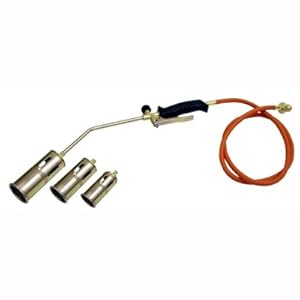

That's for brazing copper pipe. You'll want a way to deliver more heat, and sufficient heat over an area. You'll go through a lot of Bernz-O-Matic cans right quick if that's all you use.
Propane & forced air or propane & oxygen, and a roof-burner type of flame nozzle such as the people who tar roofs use, seems more the ticket.
Here's a homebuilt. Well, caveat ignitor.
