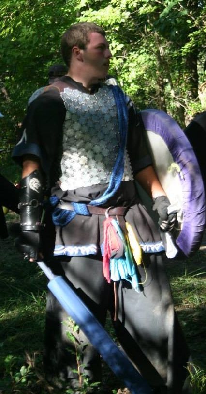

Now that the serious stuff is out of the way, here's some wierd stuff I played with a few years back.I made the punch/button set for 1 1/2" (across the flats) hexagons. I used a combination of scrap aluminum 3003 .088"thick and 6061 T6 .071"thick. The holes are .140" dia. in each corner. The .265 ID links are made from 16 gage (.062") ss spring temper wire. Inspired by an old black & white picture of Mongol horsemen posing in their armor. One of them was wearing something like this. Makes very light med protection armor designed for Amtgard. Was thinking of revisiting the hexagons with a new piece using a japanese 6 in one weave between patches of the hexagonal plates.
A more recent picture of it being worn by a young borrower.
The piece had been much longer (down to upper legs), but didn't work well till it was shortened to its present length. Longer, the piece was restrictive, and didn't have the give needed to twist between pelvis & shoulders.

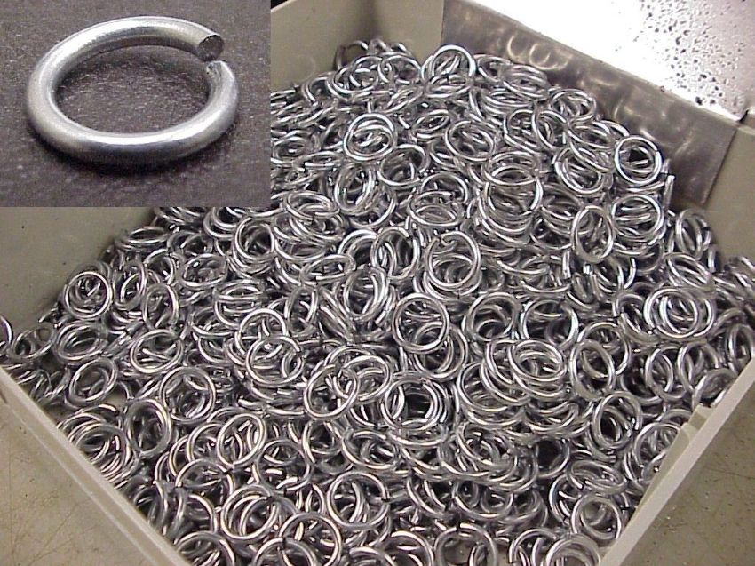

Turning to mail sources, there's a spendy solution to "full flat rings," usually called stamped or punched among the maillers: they're called "spacer rings" and washer manufacturers punch these out. Naturally, they are to any desired spec: ID, OD, thickness, material. Probably there's a minimum order from the factory. So if you're willing to deal in the necessary ten thousands, you're well off. And there's half your links already.
And there's already a LOT around the Net on building your riveted links from scratch. You use um chimpish toolz, hit um with four-pound hammer, learn um use eensy drift. Really pretty simple. Also really pretty tedious, so it's not a bad idea to have the stereo on!

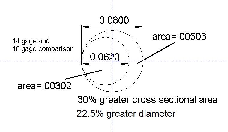

Say what? Actually, that's half and half the links. Of the four-in-one "Basic Unit" of mail, the riveted link is the one link in the center of this quincunx. The other four are closed already and you just hang them on the opened middle one and close it up. Though that 4:1 ratio doesn't hold up long; when you've woven a mailpatch of the stuff, you end up with alternating rows of punched solids and of riveted links, likely with a slight bias towards the punched ones, which would be on either edge -- the sides, not the top and bottom. With a completed article or shirt of mail, even that much bias nearly disappears. And you still save half the weaving time.and if spacer rings aren't a viable option it's still 1/5th on a 4 in one weave...
This yields you mail about half the weight, perhaps rather more, of the usual butted, for fifteen times the strength. I'd say that sounds pretty worthy to me, and all the more so in a demo/living-history context -- up close, what real mail was really like. You can lighten the load further if you're willing to limp along on a mere ten times.
Typically, it's 5/8 the weight, comparing 18ga wire (.048") to 14ga (.080") -- a hair less than 5/8 the wire diameter. Getting the spacer rings made slenderer than .048" will save further weight, and with twenty thousand rings that can really add up.

Now, having just hopped off the scale with and without my armour I can say that just the torso armour weighs 20 lbs, give or take a little as bathroom scales aren't the most accurate. keeping that in mind I'd guestimate the whole suit at around 50 lbs, maybe as much as 60 lbs.
Lost Celt, that banding you found at McMaster Carr should be perfect, that's the same kind of banding I used for mine. that black lacquer on them is tough though. I got the bulk of mine stripped off and the plates polished in an industrial tumbling machine, I worked at the place so it was free for me, but we charged customers about $75 per load. that said, everything I've done since the initial build I've cleaned myself using a drill mounted flap disc then given a quick once over with a purple scotchbrite pad. it matches the tumbled ones almost exactly and after a bit of weathering is indistinguishable. I think the flap disc was 120 grit but I cant find it to say for sure.
Alternately if one side is just plain black you could leave that as the outside, I've got some apocalypse themed maille and plates that I used 3/4" banding for and didn't clean it of. the blackening on them gradually wears off at the overlaps, but personally I find it to be an aesthetically pleasing wear pattern, it actually matches really well with pieces that i've blackened with linseed oil. Sometimes I wish I'd done the same for my other maille and plates.
Oh, I counted the plates, I've got a total of 190 plates in mine currently but I removed the plates below the waist and replaced them with maille and also took out the 2 rows of plates at the top of the shoulder, so it's a little different than in the picture right now.
As for the front closure I used 7 straps and buckles. They're just riveted into every third plate up the opening.
For your rings you said your having trouble riveting them? are you using the rivets that came with them? I got my rings from Ice Falcon and I found that the supplied rivets were way to hard to peen with pliers, normalizing them helped a little but in the end I just made my own rivets. All I did was get a roll of re-bar wire, it's 16 gauge and dead soft to start with, then I just cut little 3/32 or so bits of wire and used them as the rivets. Even with the time spent cutting them it was faster than struggling with the rivets that came with the rings. So that's something you might want to try. also, check over your rings that made a satisfying popping sound, with mine at least I found that the popping usually indicated that I had swelled the rivet enough to crack the ring. I find that on a good ring you can feel the rivet mushroom through the tongs, but it doesn't make any sound.
Once your through the learning curve I find that it goes at about half the speed of butted maille, but you make up for that in not having to spend an hour or so on repairs after every time you use it. since I switched to riveted rings I've only replaced 3 or 4 rings.
Lastly had you given any thought to how you were going to pattern out your plates?my first build i just did straight columns, it worked but it could have definitely been better. since then the best way I've found is to have a friend duct tape you into a shirt, then cut it off. stuff it with newspaper to make it you shaped again then draw on where you want your columns of plates to go leave space for the maille and dont forget the hourglass shaped row down your spine, that one row will take care of 90% of your tailoring. once you've got it all marked out cut it out, transfer it onto some poster board or something like that, clean it up and straighten the edged then use that as a template for fitting your plates against. i cut and fit my plates against the template, stacking them in place as i go, then once you've got a column done i come back and punch all my holes. then i lay them back out again, and run a bit of tape up both sides to keep them together and repeat the process for the next column. once i have a few done i come back and put them together with the maille, that way i can weave rings through the holes in the plates, but use pre riveted rings for the center and theoretically save myself a little time.
also you'll probably find it easier to curve 2' sections of banding and cut plates from that than try to curve hundreds of 4" sections and keep them consistent.
Anyways, this has turned into more than a quick post, so I hope some of that is useful. if there is anything else i can help with just ask.

Second, you read my mind on the fitting. Getting the rings was the first part - I can join 1/4 of them together while I get the rest together and I was just thinking about this the night before. I was considering the newspaper/chickenwire/duct tape thing for the exact same reason. I can eyeball it, but if you're wanting to put it together I'd want to start at the spine and work toward the chest, So you caught me at the "how the hell am I going to put it all together bit?"
