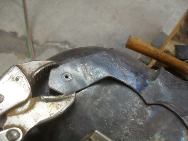

A thing that's been nagging me about the visor is that the pivots are too high, so I thought I'd begin by moving them down a bit. This involves riveting the visor down at three points, and hot bending the arm. I was able to lower them about 1/4" or so. Twice that would have been better, but that would not be easy to do.
Then I welded up the old hole, and reasembled the visor to drill a new hole. After riveting the new visor pivot location, the wrinkle in the arm gets hot raised back down.

by Mac
Barbanegra wrote:
Mac wrote:
The worst case scenario for these rivets would be that someone landed a mace or war hammer directly on one and crushed it down. This might cause the rivet shank to protrude into the helmet. That sounds nasty, but I think you could probably spend all day trying to do that to these rivets and never actually hit one hard enough and straight enough for it to be a big problem.
Mac, would it be possible then to treat the rivet shank as a verveille of sorts to prevent that from happening, like this:
Barba,
You could do that, but I would be surprised if they did. I guess if I this helmet were destined to be be beaten about by the brutes in the Battle of the Nations or something like that I might consider some sort of step or collar on the shanks.
The problem would be getting the length right, so that the cap would sit squarely on the helmet. I suppose if the step were a millimeter or so deeper into the cap, you would be able to rivet it up nicely. If it were struck, it could only intrude into the helmet by that millimeter.
