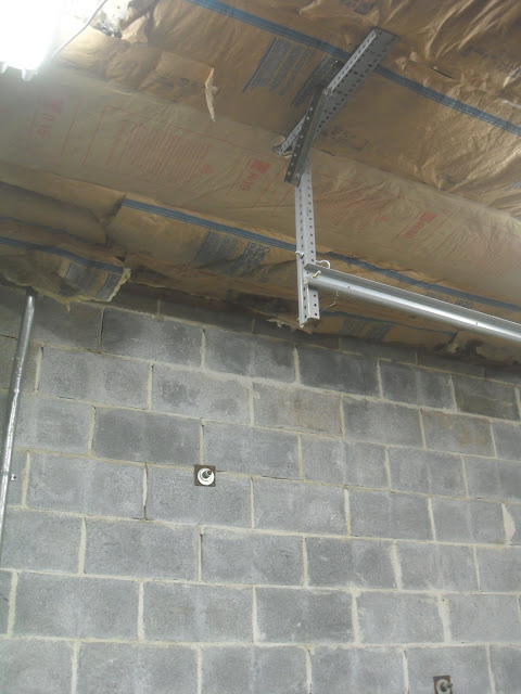

The other pressing issue is about the kiln. As far as I know, it's wired and ready to go....
... but the ceiling directly above it has paper covered insulation between the joists.
I don't know if opening the orange-hot kiln a mere seven feet below this paper will create a problem, but I would rather not find out. There will have to be something between the kiln and the insulation. I'm not ready to sheet-rock the ceiling yet, so perhaps some sort of shield interposed between the two will be the path of least resistance. A sheet of plywood hanging from wires at its corners might do the trick.

They make a foil-laminated OSB sheet for radiant heat barriers under roofing. Your local big-box hardware store will likely have it. Might be more effective at resisting the heat than a sheet of plywood.
