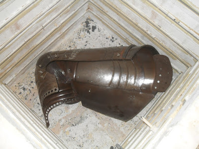

It well neigh time to get this show on the road.
The first thing to go into the kiln will be the cuisses.
We can see that they are not going to fit without some disassembly . Even if they did fit, this would be a poor way to do it. Laying on their sides like that is an invitation to warpage.
First things first, though. The straps have to come off and be saved for reference. They will not be reused, but their lengths will tell me how long to make the final ones. Note that the holes that are the correct tension are circled.
When I installed the temporary tabs, I put washers on the outside so that I could grind the rivets with impunity. Note, how the sparks are getting sucked into the dust collector. It's important not to let red hot washers get sucked in. That sets the dust bin to smoldering, which is exciting, but bad.
A sharp rap with a light hammer drives the rivets out.
Here, I was thinking about how to support the knees in the kiln. I thought about making a fixture to support them in a partially flaxed position, but in the the end, I opted to lay them flat on a fixture I already have.
This is how they will sit in the kiln.
Before going any further, I traced the outlines of the main plates so that I have a reference to return them to if they warp.
Likewise for the demigreave and demicuisse.
These assembly marks will help to keep me from trying to put them together wrong months from now. Don't laugh. If you have never made that mistake, it's only a matter of time.
This is what I have settled on for the wires. The wire that goes from end to end will be the "let in" loop, and the one at the end will be the "take out" loop. The let in is long, and it will probably fall over when it is hot, but by that time it will have done its job. The take out is shorter and stiffer so that I can be sure to snatch it with the hook. It's on the top, so that the entire assembly will enter the quench symmetrically. To do otherwise invites warpage. As it is, the wing will brobably do something weird, but with luck it will be easy to fix.
It is important to do "cold runs" to test whether or not the wiring will do the right thing. When the pieces are hot is not time to find that out. Here is what the knees will look like being slung into the kiln. The support fixture will be in there already.
And this is how they will come out.
The cuisses will go in horizontally, and lay on their fronts. I have the let in loop attached to a brace that supports the back flap.
The take out loop is arranged so the that the cuisses will enter the quench vertically. I have used two thicknesses of 16ga wire here. When the wire is at the hardening temperature, it will be a soft as butcher's twine, and I felt like one thickness was going to be too floppy.

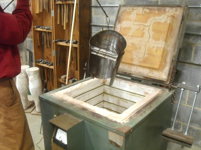

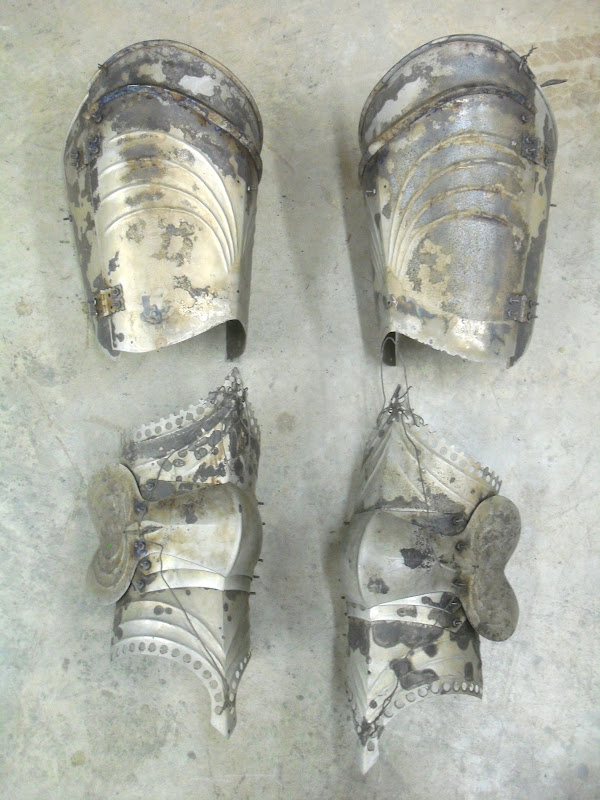

I got the cuisses and knees hardened this evening. My first impression is that it went well. There is a bit of curling up of the cuisses, I think, but that should not be too hard to fix.
All the parts were hardened at 1450, and quenched in 13% Aqua Quench at around 95 to 100. They were rinsed off in room temperature water and then put in the shop range at (what is said to be) 450 for ten minutes. That will make them stable enough to ignore.
Tomorrow, I will have a careful look at them and start the final tempering and warp remediation program.

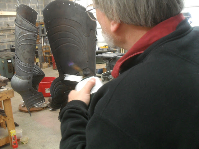

Today I did the final tempering and the first phase of warp remediation.
My bracing of the cuisses was pretty ineffectual. Somehow, I lost track of what effect the hinges have on the whole thing. As we can see, they curled up a bit.
Having disassembled things a bit, we can see that the main plate is now narrower than the tracing I made yesterday.
This will have to be shoved back during the tempering. I usually cut an aluminum brace and jam it in, but today I had a clever idea. I made the brace in two pieces, so that I could shape each end properly without having to pry it into place to check the fit.
Using a measurement I took from comparing the cuise to its tracing, I mad a mark to indicate where the brace needed to be screwed together.
That turned out to be a bit ambitious for one go, so I drilled another hole with the brace about half way to my mark.
The bottom needed to be wired to keep it from spreading along with the top.
I put the cuisse in the kiln at about 750 for a few minutes and checked my progress. This pic shows the cuisse in between dips into the kiln. I have rebolted the brace to a greater length, and sprung it back into place.
It went back into the kiln for a few minutes, and the results were good. I repeated the procedure on the other cuisse. It was not a badly curled, and I was able to do it in one go.
The knees had curled in a bit as well, but not very much. They are not as strong as the cuisses, because they do not have hems. This lets me use thinner braces.
Both knees got a similar treatment.
Here is what everything looks like now. There are still some things that will need correction, but that will probably happen under the hammer.

Do you not need to overcompensate in the bracing? I would have guessed that even with bracing during tempering, that the shape may still have some elasticity drawing it back to its post-quench shape.
Re: Dusting off the cobwebs
Great to see the details of this process! I would not have thought of correcting warps like that.
I have not found spring back to be much of an issue. When the parts come back out of the kiln after tempering, the braces practically fall out.
In truth, I don't know as much about this business as I would like to. Indeed, I can't even remember where I got the idea from. The upshot is that if you apply a stress to the steel while it is in the tempering temperature range, it will creep to relieve the stress. I suspect it is one of those time/temperature things, and that the steel will creep faster at higher temperatures.
You can do this by hand, and with a torch. I have done it before, and will probably do it again. You can clamp the work in a vise and twist it the way you need it to go while playing a flame over it. When it gets into the tempering temperature range, you can feel the steel yield. I suspect that remarkable things can be accomplished this way in experienced hands... all without much adverse effect on the hardness.

Yesterday, I returned my attention to to warp remediation. Although the width of the bottom of the cuisse matches the width of the corresponding place on the knee assembly, there is a discrepancy in the shape.
This smooths itself out when all three bolts are in place....
.... but I really want it to be a nice "relaxed" sort of fit. To that end, I figured that playing a propane torch over the problem areas while everything was assembled up would do the trick. Hanging the cuisses from chains let me do that at a convenient level.
Unfortunately, even after repeated attempts, the parts would not just lie down and behave themselves. This sort of repair with the torch usually involves overcorrection to allow for springback, and I think that is the problem here. I need to get more area hot to make this work.
So, I have put the braces back in and bolted everything back together. I plan to put the entire cuisse assemblies into the kiln at about 750°f - 800°f and see if that does not subdue the trouble. The kiln is warming up now, and I have laid some "furniture" on the kiln floor to keep the cuisse from rolling on its side.
Robert MacPherson
That trick worked well. The parts now fit in a relaxed sort of way. This pic shows the overlap with one of the bolts removed, and the other two loosened up.
