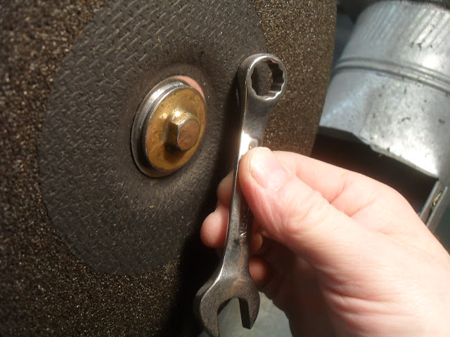

The discs will mount on my horizontal spindle. There is a male 5/8"-11 thread to accept them.
With a disc in place, I thread a retaining screw into the female 5/16"-24 hole in the spindle....
.... and give it a little twist with a "stubby" wrench that hangs on the machine for the purpose.
The screw keeps the disc from unwinding and falling off the spindle as the machine slows down. That's usually not a problem, but if it does happen, it's a lot of trouble, so I'm pretty conscientious about making sure the screw is in place.

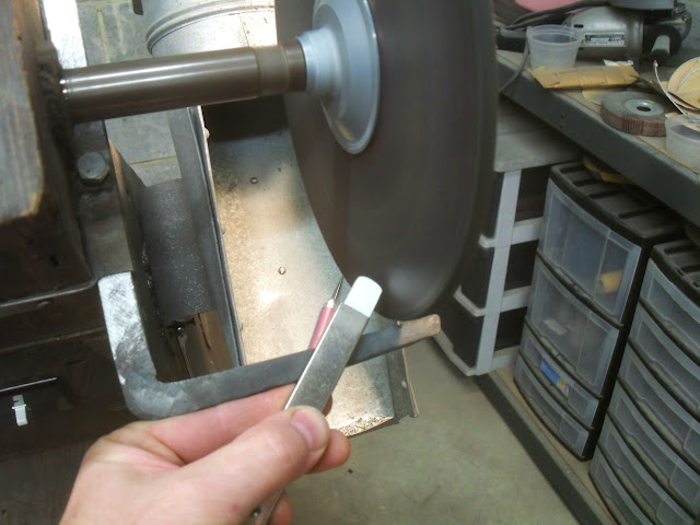

The first thing I need to do is get the grinding discs ready to use. There are two things that need attention. The obvious one is the shape of the "working edge" of the disc. We are going to need to dress that off nice and smooth, so it does not gouge the work. Unfortunately, there is a catch. These discs are never really spin true. By the time the manufacturers get the abrasive mounted on the ZDC hub, there is always some run-out. Here is what a new disc looks like in motion. That fuzzy black thing is the disc. The reason it's out of focus is because it is wobbling.
Now, you might say, "so long as the working edge of the disc is true, who cares what the back of the disc is doing!" Here's the problem with that. If we dress the face, but ignore the run-out, the disc will be end up out of balance because there will be a thick spot and a thin spot 180 apart. This will make the machine vibrate, and that will compromise the work. In addition, the working face will get out of true all the sooner if the disc is also out of balance. So, we have to start by getting the disc to run pretty true before dressing the face.
To do this, I mount up the tool rest so that I can use it to steady a welding chalk to mark the back of the spinning disc.
To make the correction, we must file away a bit of metal from the seating face of the hub, directly opposite the chalk mark. I have marked it wit a sharpy here for illustrative purposes only. I usually just lay the disc down in the same orientation, and remember that I must remove materiel from the opposite side.
Those circumferential marks tell us where the zinc hub is making contact with the steel face on the spindle. There will be one on the side with the chalk mark, and we leave that one alone. There will be one or two (sometimes more) on the opposite side from the chalk mark, and we must be sure to file them away.
By repeating the process a few times, the disc will come to run true enough that the chalk makes a mark most of the way around. It would be nice to continue until the mark want all the way, but diminishing returns makes it unnecessary as well as difficult.
After the run-out is minimized, the face is dressed with a diamond. Here is a pic of my new dresser compared with my old one. This work is pretty abusive to diamonds.
This edge is dressed and ready to use.

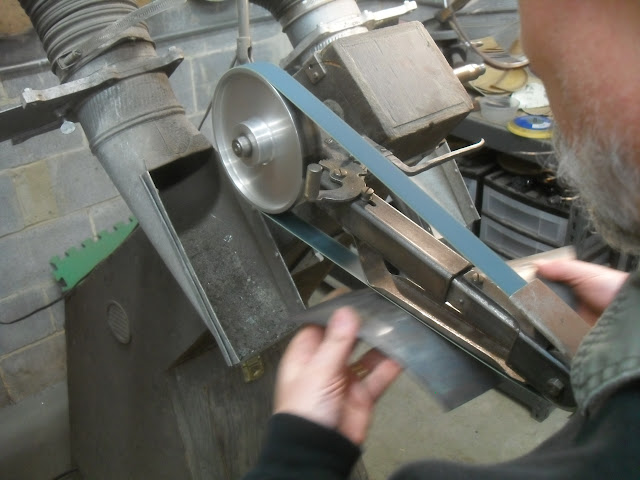

I am always a bit reluctant to just take everything apart and get the process started. The cuisses looked nice in a more or less uniform blue/grey, and the flutes showed up well. Once the grinding starts the flutes will disappear in the grind lines and won't be visible again for days or weeks.
The first thing that has to happen is to grind away the hammer marks and "level" the surfaces, and the belt sander is well suited to that. I set it up with a fresh 80 grit aluminum/zirconium belt, and chose the flattest platen I thought would get into the curves. I plan to take three passes this way wherever that is possible.
My first pass on the cuisse backs is parallel to the upper hem.
Once I have ground away all the marks I can see, I am left with a couple places that are too deep the grind. These get plannished out, face down on a stake, and then ground.
The second pass is parallel to the bottom edge. I try to remove all of the previous scratches. Obviously, I can't get up close to the hem with this pass, but neither could the guys in the 15th C. The areas adjacent to hems always show more mistakes from the early grinding than other areas. That's just the nature of the thing.
The third pass splits the difference between the previous two. Again, I try to remove any scratch I can reach.
I'll give these another close looking at before I move on, but for now, they look OK.
These are all the places I can reach with the belt sander....

I have to disagree. The vambrace plate above has had the following treatment.....
--three passes at different angles of an 80gr belt, backed with a firm platen to remove the hammer marks and level the surface
--one pass of an 80gr belt, backed with padded platen to remove the facets from the firm platen passes
--one pass under a slack 80gr belt to blend the surface a bit more
--two passes at different angles with 320gr
The 320 is in the form of 1" aluminum oxide strip on the cylindrical face of a 12" MDF wheel. There is a layer of felt between the MDF and the sanding strip. I'll show pics of the wheel later.
I am not sure where I will go from here, but I certainly will not introduce any steps between 80 and 320.
There are two things I want to show you. The first it the effect of heat treatment on the degree of luster in the finish. The hinge rivet hole had to be moved on this plate, and I had welded up the old hole. That area has been above the austinitization temperature and has air quenched. The structure is probably perlitic, rather than martinsitic, since I had no trouble punching the new hole, but it it certainly harder than the surrounding area. You can see in the outside pic how much brighter the finish is. Harder steel takes a brighter finish.
The other thing I want to say is about finishing processes in general. Many folks will tell you that the key to getting a good finish is in not skipping over any of the grits. They would have you go dutifully from one to the next... 80gr-120gr-180gr-220gr-280gr-320gr-400gr-600gr, and then on to a series of polishing compounds.
