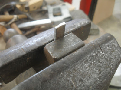

The small vise I use for this work has special jaws. They are mild steel, and the one on the "handle side" of the vise has a small radius in its upper arris. The jaws also protrude higher above the vise castings than the original ones. These are all desirable features for making hinges and buckle plates. The mild steel does not mark the work like the original (serrated steel) jaws. The radius allows the work to be set deeper into the jaws. The protrusion keeps me from striking the cast iron with the heel or toe of the hammer. The softness of the mild steel lets me saw or file right down to the jaws without dulling my tools. As the mild steel jaws wear from all that cutting and filing, they can be dressed back to shape. I have been using these jaws for decades now. The original jaws and their screws are in a plastic bag on the shelf under the bench, in case I need them.
The plate is clamped up in the vise and the the bulge in the fold is hammered with a small square faced hammer.
This is not so tidy as I would like, but it is sufficient. When the bulge is brought more of less to round, the mandrel will come out without any trouble. If you can pull the mandrel out, it probably still needs a bit more hammering.
I used the disc sander to bring the sides down even and make the plates pass through the buckles. I purposely chose the smallest buckle of the batch as the gauge. That will save having to match them up later.

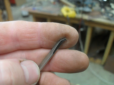

Here, I am back to the vise to cut the notches for the buckle tongues. I have made a center mark by eye, and then used that to make the marks that delineate the two cuts of the saw. This is my special "hinge saw". It has a dull fine tooth blade. I use it for nothing else. Note, the use to the thumb to steady the initial strokes of the saw.
This is the chisel I use for taking out the material between the saw cuts. I have several different widths of these.
Here is the other reason for the special ablative jaws on the vise. No matter how careful you are, you will sometimes strike the jaw with the chisel. With the mild steel jaws, that's just not an issue.

Meanwhile, I need tongues for 21 buckles. I want them all to be more or less identical, and I want to make them with as few reject as possible. I spent some time messing with the lengths and other parameters until I came up with at procedure.
I start with a 3/16" strip of .060" mild steel. This gets cut on the big shears, and comes off as a tight spiral that needs to be flattened and straitened.
The first step is to forge a taper on the end of the strip. This is one of those processes that can be frustrating, but practice and a big hammer help.
The completed taper should be more or less square at the tip.
Image Image
Next, I bend the tip down with a small hammer.
Image Image
Then I round off the upper edges on a sanding disc followed by a scotchbrite wheel.
I have made two reference marks on the anvil face. The first shows where to part the tongue from the stock.
Image Image
The rectangular part of the tongue will get rolled around the center bar of the buckle. It needs to be thinned out a bit so that it will roll nicely. This gets done with a cross peen...
....followed by a more or less flat faced hammer to smooth out the cross peen marks.
What I am aiming for is an increase in length that will bring me to the second mark....
... and a smooth gradual taper in thickness.
I have cleaned up the sides a bit as well. Ideally, the part that gets rolled should be more or less rectangular.
After starting the roll over radius on whatever stake or anvil comes to hand, I tap it around and try to get it nice and even.
Here is the growing pile of tongues. The buckle blank serves as a standard to make sure they are OK.
These will all need further finishing work. Perhaps that will be later today.
