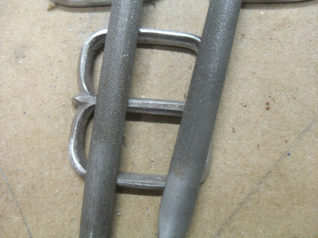

Things are moving along on the buckles. I raided my watch bench and found a nice fine half-round needle file.
The trouble areas are the insides of the bows....
... and the little nibs on the outsides.
I was able to continue the outsides of the frames with a couple of grades of Scotchbrite de-burring wheels, but the insides needed greaseless compound on felt bobs. That was supplied with the Dremel tool. This was a bit tedious because of how fast the compound wore off of the bobs. I had three of them to rotate in, but they were each only good for a couple of buckles before they needed to be recharged and let to dry.
I'll give therm all a good looking at tomorrow to see if I missed any scratches, but I think they are ready for the black emery wheel.

Now... down at the ankle of the greaves we have another issue. The statue seems to show an external hinge on the lateral side and what appears to be an internal hinge on the medial side. I think we can presume that the greave hinges on the lateral side, and that this other hinge is a loose-pin fastener. I hate to deviate from the statue any more than I have to, but I am going to do something different here. Had I been thinking more clearly a couple of months ago, I might have made up a loose-pin fastener for the greave ankles, but to do that now would be quite a bit of trouble. I am going to use a different sort of mechanical fastener instead, and that will be a turning pin.
So... I will need two turning pins for the greave ankles. I will also need some way to attach the sabatons in a removable fashion. That will either be with two turning pins (each), or one turning pin and an rivet in a keyhole. I need to look at some example of removable sabatons to see how they liked to solve this problem "back in the day". That brings us up to either four or six turning pins, depending.
Yesterday I started up a small batch of turning pins. These start out as 3/16" button head rivets. the first thing is to flatten the heads from side to side on the anvil. Those needle-nose visegrips have a shallow channel cut in each jaw to make them grip the shanks better.
I then cross peen one of the lobes over the corner of the anvil to lengthen it a bit.
That makes them look like this.
The other lobe gets ground away....
...and then filed.
I use the dremel tool with a cutoff wheel to start defining the roots of the "flags".....
... and then clean that up with a file.
Today, I will be reducing the ends of these guys to form the pivot/rivet shanks.
