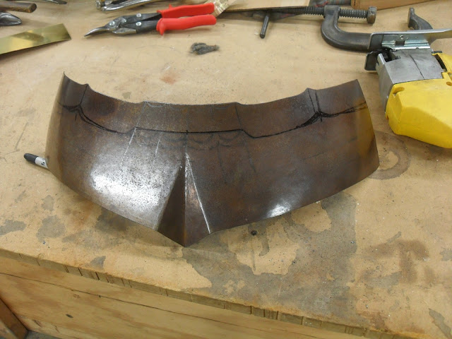

It's important to really look at your source material. I thought I understood what was happening with the backplate and cullet, but it turns out I didn't.
At first glance, it looks like the cullet is three lames, with the third one coming to a deep point.....so that's what I did.
But I had a nagging feeling that something was wrong. Elsewhere on the altarpiece is a painting of a similar armor. This armor has a cullet of three lames plus a pointed butt-tasset.
This afternoon, while I was comparing what I had and the proposed fluting lines with my pictures, I noticed that there was something funny going on with the side tassets. They seemed not to be going over the third lame of the cullet. If anything, they were going under it.
The sculptor has presented us with a sort of an M.C.Escher thing. The side tassets seem to be going under a thing that they should be going over. My conclusion is that he meant to make the cullet have a separate "arsette" but forgot about that idea, and did not indicate the upper edge of it. Perhaps he neglected to leave himself the material he needed to carve the straps and said "screw it! it's in the back and nobody can see it".
I have written my Patron to see how he feels about changing over to a cullet with a butt-tasset. I am in favor, even though I will have to rebuild the last lame. I await his reply.
In the mean time, I will start cleaning up the backplate and finalizing the flute lines.

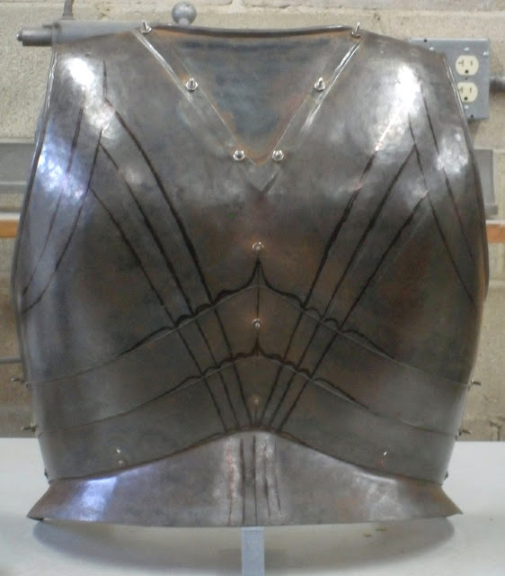

Does anybody see weirdness of the backplate construction?
Re: Dusting off the cobwebs
Posted: Thu Mar 27, 2014 8:50 am
by Signo
The weirdness is that the waistline raise considerably on the spine, so much that the belt that old the pansiere si splitted in two parts.
Is this?
Posted: Thu Mar 27, 2014 8:56 am
by Tom B.
Do you mean that there is no hourglass shaped plate in the middle at the waist?
There is a plate overlap right at the waist location.
Tom
Posted: Thu Mar 27, 2014 9:28 am
by Ckanite
Would it be the rather backward position of the tassets?
Posted: Thu Mar 27, 2014 11:26 am
by Mac
Tom B. wrote: There is a plate overlap right at the waist location.
Tom
Tom's got it. Two points.

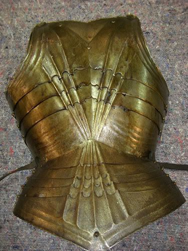

The usual construction has the waist lame extend some distance up the back, like this one....
....we can tell that this in not what's happening in St. Florian's back because of the scalloping where the flutes end at the waist.
I am not certain that we can trust the sculptor implicitly here... but it is harmless enough to do it his way, so that's what I did.

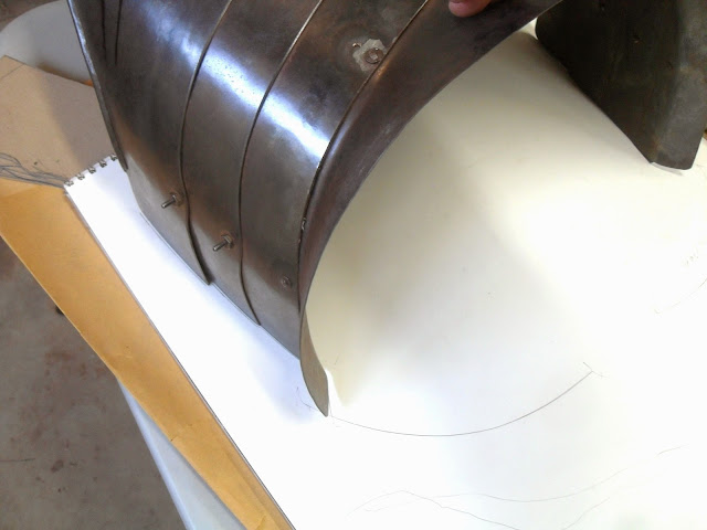

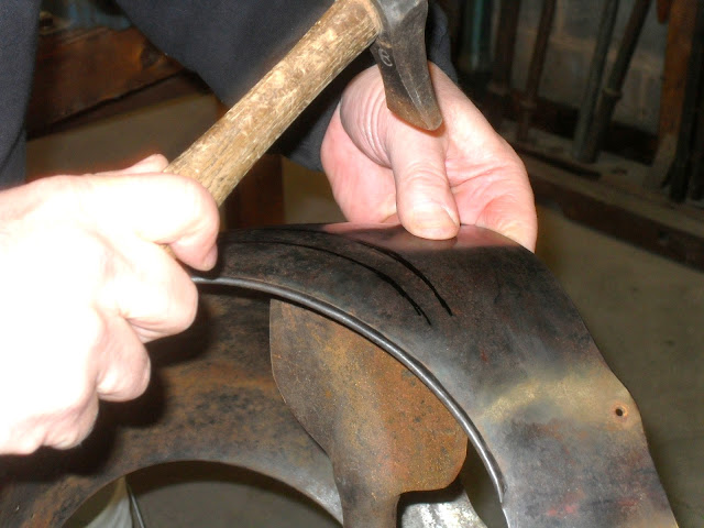

Here's what the flute pattern will look like on the back. In the statue, we can not see the upper extent of the flutes, but it is an excellent bet that they end by stopping against one or more flutes that are more or less parallel to the armscye.
Prier to putting in any of the fluting, I have traced the edge of the backplate. This will give me a reference to work back to when correcting for the inevitable distortion.

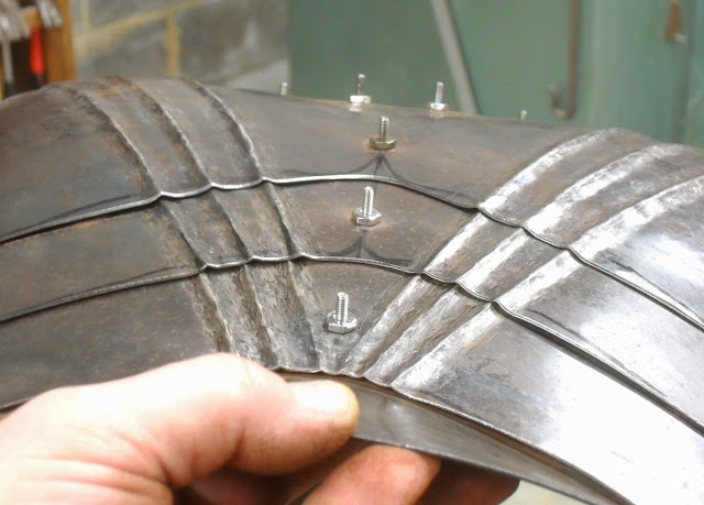

Before going on, I would like to take a didactic digression, and say something about flutes. There are pretty much only four ways a flute can end....
--It can fade out.
--It can stop against a "half " or "step" flute.
--It can stop against a sunk band or border.
--It can meet another flute at an acute angle along a crest line.
If it ends in any of these ways, it is admissible of grinding with a wheel or abrading with a file.
A flute can not end end by stopping against a hem. A flute can not end by stopping against a "full" flute. Either of these will be impossible to grind or file. The first is pretty obvious. The second is less so, so I have made up a test piece to demonstrate the problem.
Here is an upper back lame from my scrap box. On the one side I have laid in a "half" flute followed by a "full" flute for the three-flute-spray to stop against. On the other side, I have laid in two "full" flutes.
Next, I laid in the sprays of flutes.
A few minutes on the grinder shows off the difference. The spray stopped against the half flute grinds out very nicely. By contrast the spray stopped against the full flute has "pockets" that can not be reached.
For this reason, the first of the flutes around the armscye must be a half flute. Laying in a half flute or step flute is just like laying in a full flute, except that you only strike on one side of the line.
The second flute is a full flute.
Before laying in the sprays, I checked for distortion of the upper back...
.....and corrected it.
This is as far as I am going with the fluting tonight.
Tomorrow I will flute the two lames, and get everything to match up.

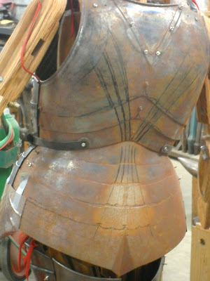

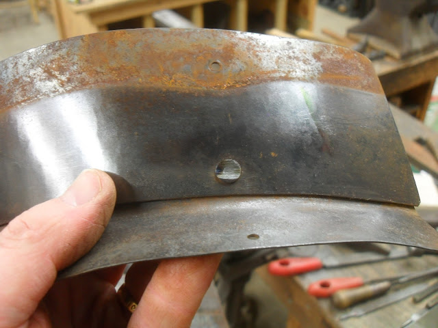

I took some other pics this afternoon that show something about the construction history of this back. This is back #2 1/2...more or less. Back #1 had a shortfall at the sides, and some other problems as well. I kept the waist lame, and replaced the two lames and the upper back. At the fitting, I found I had to restructure it again. I can not remember exactly what I did, except that it involved welding up and moving some holes, and replacing the upper back again, and then shortening it at the top.
The old shoulder strap holes and the new ones.
This is where the waist belt will be riveted on. The holes pass through the first back lame and the flange of the waist lame. I have a temporary rivet through one, and the other is where I bolt the temporary belt. If you look closely, you can see a welded up hole and three quarters just to the right of the others.
The hole in the underlapping lame has been welded up and moved down a bit.
I guess what I am trying to show is that sometimes it's best to replace a plate and other times it makes more sense to weld and move ahead. As long as it is structurally sound, and looks good when the armor is done.....

The lames are narrow, thin, not highly shaped. Thus, they distorted quite a bit from the fluting.
This I corrected with a mallet and a sandbag, as well as a bit of wrestling over the horn.
The first lame was temporarily riveted to the waist lame. I always put a sacrificial washer on temporary rivets. This makes it easier and safer to remove them. I grind away the piened head until it is gone. The washer keeps the plate from being touched by the grinder.
Once the head is ground away, I drive the rivet out with a punch.
The bolster for driving out the rivets has a hole cross-drilled through it so the waste rivets can be cleared out.
Flutes never line up as nicely as one would hope....
A bit of hammering on the assembled parts over the fluting stake goes a long way to setting them to right.
Here's what the back looks like with the flutes complete, and the edges scalloped. The central notches (in black sharpy) will not be cut until the parts are heat treated.

Last night I spent a couple of hours working on the cullet modification. In the end, I had a template and a plan. The old lame #3 was to become the butt-tasset, and I would make a new, narrower lame to replace it.
Here is the new template. The black lines are proposed modifications of the edges of lames #1 and #2.
A few more words about cutting with the jigsaw....
Here's an armorer's view of the process. Note that the blade cuts the marker line away. You can see that I have lightly centerpunched the pivot location. You can also see that I have ditched the gloves I was using the other day. As I settle back into this, I remembered that I always hated the gloves.
Here's a right angle cut. You can't do this with a Beverly shear.
I wish I could remember whom it was who told me to use a Vicegrips rather than a C-clamp to hold the stock to the cutting bench. I had used a C-clamp for years, and never desired anything more. It seemed harmless to try. Well, they were right..... Vicegrips are much better! You can move the clamp much faster, and with one hand.
With the new lame #3 all shaped up and in place, It's time to turn out attention to turning the old one into the tasset.
I have some lines on the old lame, and I will use the jigsaw to cut it down.
A 2X2 clamped to the cutting bench serves as a support during this process.
This is what it now looks like with the various tassets taped in place.
Tomorrow...fluting. Tonight....a violin concert.
