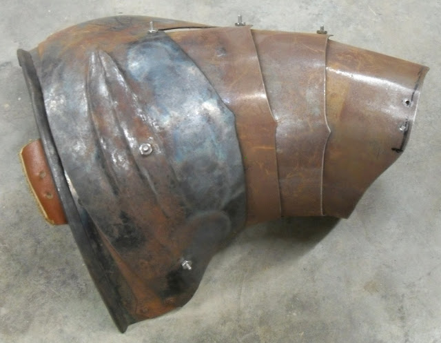

And now the exciting part.
Will McLean (Galleron) was kind enough to come over yesterday and play body double for my Patron.
When it was all said and done, I could see that there were some fundamental problems with the pauldrons. The first is that I have put the upper arm too far back. In this pic, we can see how the edge of the pauldron's main plate presses against his arm. This has two undesirable effects. First, it shoves the entire assembly around so that it is closer at the neck in front. This is about the last thing we want. There is already precious little room for the pauldron to move in that direction before kit tries to choke the wearer. Second, it does not leave any room for the intrusion of underlapping lames. When the lower lames of the pauldron are compressed, they have to go somewhere, and there has to be room for that to happen. These faults are probably the greatest cause of the pauldrons not working correctly at the fitting with my Patron years ago.
The other issue is about how this opening in the pauldron sits with respect to the arm. We can see here that it is higher in back than in front. It should be more like level, or if anything, sloping the other way. The way it is biases the neutral position of the arm slightly back. This robs us us of motion, and tends to shove the entire pauldron back....pressing it even harder against the front of the shoulder where we saw that there was already not enough room.
The solution involves making the pauldrons over again. This is odious, but it will give me a chance to make a couple other changes as well. I am going to lengthen them a bit, both front and back.
The basic fault mine on three counts. The first is setting Massimo's shoulders too far back. The second is relying on a fundamentally flawed manikin. (this is Hubris) The third is not recognizing the problem earlier. There may be additional counts.....It all depends on how much I beat myself up over this.
Overall, though, I have a feeling of catharsis. I think I understand where the problem lie, and I think I know how to proceed. I started on the new template last night, and hope to have something cut out and shaped up in the next couple of days.

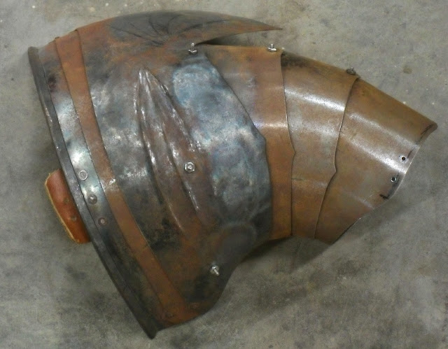

The other day, James A G wrote me with some ideas and sketches and shamed me into looking again at the "tubes within tubes". The thing he suggested was making the upper back edges of the tubes curl in a bit. These edges limit the motion of the lames by striking against the inside of the lame above and wedging the lame in front.
Well...I tried that and got a significant improvement in motion.
That motion comes at the cost of further bulk in the front of the shoulder, but I am about to fix the lack of room there by rebuilding the main plates. So.... the tubes within tubes may be back. We will see.

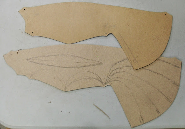

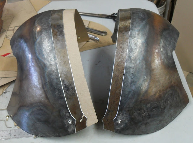

Today I cut out a couple of new pauldron main plates and started shaping them up. I hope to have them ready for templating the first lame on the neck side by tomorrow.
The new template is quite a bit bigger than the old one. I may end up trimming a bit, but then again maybe not.

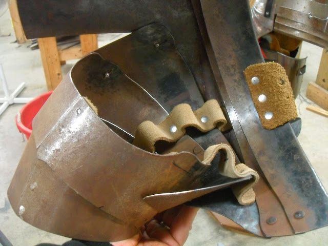

I use a heavy (8oz.?) chrome split, and break it aggressively over a hatchet stake before use. In a pinch, I have used two (4oz.?) layers of "nubuck" glued grain side to grain side with contact cement.
There are a couple of things that I have seen that lead to trouble....johnameyer wrote:any advice on designing such articulation? Where do people normally get it wrong etc.?
----Using too stiff a leather. Almost all leather you are likely to try will be too stiff to use for internal leathers. The real stuff was buff leather. Buff is produced by denaturing the hides with marine oils over a period of months. When it is done, it is supple and not at all greasy. Beware of stuff sold as "oil tanned" leather. It is not the same thing. It's usually just some usual sort of tannage that has been dressed with too much grease.
While I am on the topic, I would like to point out that it is a fallacy to think that it is somehow more authentic to use vegetable tanned leather in lieu of buff. Substituting an available authentic material for an unavailable one does not garner "points" if the material does not have the right properties to do the job. Better to use a modern tannage that works than an historical one that doesn't.
----Placing the internal rivets too far from the edge of the plate. For internal leathers, putting the rivets close to the edge is essential. If the edge of the plate sticks out past the head of the rivet, the rivet is too far away.
----Making the lames two narrow. If the lames are too narrow the joint comes to be "all rivet and no leather". The lames I made the other day are really right on the edge. They are 1" wide.
These pics are of the assembly I just mentioned with 1" wide lames.
As any internally leathered joint is compressed, it displays one of two distinct modes.
The first is a sort of springy, bulging mode. The plates still lay relatively close to one another. This is what you probably want in an articulated collar.
The second is a full on overlap. The leather doubles back on its self, and the plates separate quite a bit.
Really narrow lames will only display the forst mode. Wider lames enter the second mode with a bit of force. The wider the lames, the greater the travel in mode one. Further, since the amount of potential travel that is used up in the thickness of the leather as it bends back on it's self is constant, within reasonable limits, wider lames will give more travel in proportion to width. If I had made these lames 1 1/4" wide and used the same leather and rivets, they would probably work better.

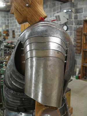

I got the first upper lames in today, and got a start on templating the second ones.
I am trying to decide what to do about the hem. The pics of the statue seem to show a hem that is tall and narrow in front and short and wide in back. On Mk1 I "compromised" and just made them a medium sized triangle of constant proportion.
Oh, and there's something else weird about the upper lames. Who can tell me what is it?
Robert MacPherson
Re: Dusting off the cobwebs
No signs of rivet heads to pin the lames for articulation.

James,James Arlen Gillaspie wrote:I messed with the tapered cones idea, to refine the look some. Pardon some extraneous lines. Perhaps I have only proved that it won't look good with arms above a certain proportion, as they need to be a bit bigger than the width of the upper arm, though not, if you measure them, all that bad (about 3 1/2 to 4, proportionally). I decided to make the patterns reflect the inner diameters. I made the rear of the cannon sections a bit convex, because that's what I'm used to seeing, but I don't know how much difference it makes.
It looks like you have put all the "conicalness" in the front and left the back pretty cylindrical. That seems like a crafty idea. I'll play around with that and see where it leads.

As to weirdness, the pictures seem to have three lames from the front, but only two at the back.
That's it!Keegan Ingrassia wrote:As to weirdness, the pictures seem to have three lames from the front, but only two at the back.
I have a couple of sketches of how this could work, but for the sake of simplicity I am assuming that the sculptor just lost track.
Robert MacPherson
Really? How would they lose track? Wouldn't the lines carry around?Mac wrote:That's it!Keegan Ingrassia wrote:As to weirdness, the pictures seem to have three lames from the front, but only two at the back.
Isn't that the third lames partly covered by the elbow?
