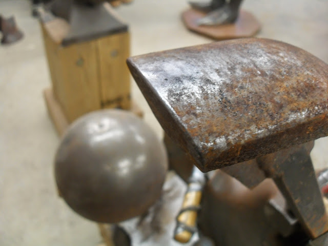

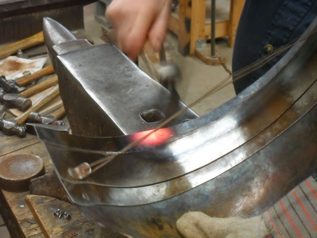

Lame number two gets a tall hem. I decided to make the hem get gradually smaller from the shoulder to the back. I made up another template for the lame with the hem allowance added on and used that template to cut out the blanks. I used the previous generation of template to mark out the line for the hem allowance on the backs of the blanks.
Having shaped up the plates in the usual manner, I used a little square-faced hammer to mark the beginning of the hem. Note how my fingers are touching the heel of the anvil under the work: this is worth doing whenever the work is narrow enough to permit it. (pay no attention to the blood blister on my thumb...I am sort of pissed about that)
The hem allowance must be flared out to just past 90 degrees. This is hot work, and it will happen in several passes. I have assembled up the other parts of the pauldrons with temporary rivets to lend support to the lame while all this is happening. In addition to that, I thought it prudent to tie the thing with wire to discourage it from spreading. You can see the little brackets under the rivets heads which provide anchors for the wire. I made them up fresh, but when I am done they will end up in the bin of heat-treating hardware. brackets like this come in handy for attaching lifting wires.
I am using a light hammer with a round face.
The first pass takes us to about 45 degrees.
The second pass is much like the first, but I have switched to a slightly flatter hammer. That vice grips keeps the lames at full extension. It is inconvenient to work around, but I think it helps to keep things from distorting. When making a big hem like this, we want very much to avoid letting the lame distort. If it does, it will be difficult to get it back to shape.
A third pass with a moderately flat hammer gets us to 90 degrees.
One more pass with the flat hammer brings us to the desired angle. I did this over a piece of RR track whose end is undercut.
After I put the camera down, I did more work over that same support, but with nothing "inside" the hem. The result was a tall, narrow triangular section. Triangular hems are difficult, and it turns out that tall narrow triangular hems are even harder. I will post pics of that later.... if I can make the results look OK. It's a bit uneven now, but I have some hope of making it look presentable this morning. If not, I will be remaking the lames....
Robert MacPherson

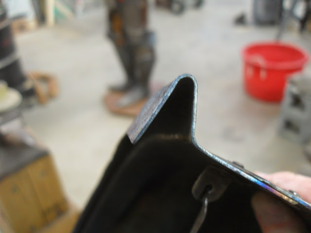

OK, well, That's just not gonna' do it.
The overall shape of the hem is not so bad.....
....but the edge has too many waves, and they are just too deep. It's not going to grind out an an acceptable way.
These lames are going into the Box of Shame, and I will start an new set after lunch. The fall back position is to do the same thing, but turn the hem to the inside.
There's a reason that armorers shifted from outside hems to inside hems. The outside ones are just plane harder to do. They end up with the edge under compression, and it wants to fall into folds. Unfortunately, that's the edge that everybody can see. Hemming to the inside lets you have a tool inside the hem during the compressive stage. It also lets you put your mistakes on the inside.
Yes. This armor is too early for inside hems, but it's clear that I just don't have the skill to do it the other way. I shall trade one sort of shame for another, but the results will be more pleasing to the eye.
Robert MacPherson

Armourkris wrote:Hey Mac, do you have that wire strung across the lame to prevent it from deforming while your hemming the edge? Because if so that is brilliant and I wish I'd thought of that about a dozen times in the past. just saying.
Just so, Armourkris. Wiring the free ends of things is a pretty good way to keep them from spreading if they are inclined to do so. I they were going to try to go the other way, you could put in a brace of angle iron. I will probably make up some braces like that when I do the heat treating.
As it happens, the pauldron did not try to spread, but I had the wires and brackets left over from the other day, and I figured there's little harm in using them fore this attempt as well.

Tomorrow I will make sure everything is nice and even and then close up the bottom.

Well Done! I've always wanted to really see how a triangular roll came together. It's great seeing everything in a very simple step by step.
