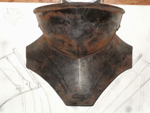

It's time to rethink the bevor. This is what I built several years ago.
Like I said yesterday, the gorget is too conical. It will get in the way of the movement of the pauldrons.
What I need to replace it with is something more like this. Note, the flatter gorget to allow freer play of the pauldrons.
Here are pics of my sketchbook with the old bevor, and then with the proposed new bevor drawn in. Side view.
Split front/back view.
I need to decide whether I will start with the chin or with the gorget plate. Probably the later, since that is the part that "interfaces" with the pauldrons, and is the thing I am most anxious to change.

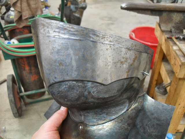

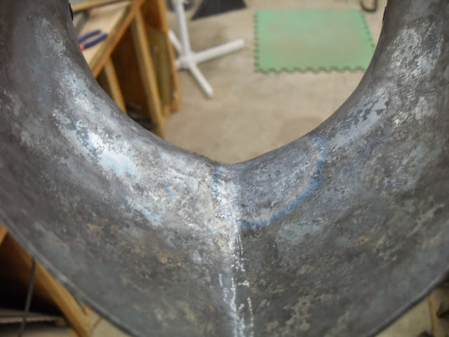

Today I started the new bevor. After cutting the chin plate out of .071 stock and smoothing the edges, I bent it roughly to shape using this bending-pipe fixture. I have scribed the center line lightly down the plate so I don't loose it too soon.
The black lines show the area that I will hammer up slightly before beginning the hot work.
Some vigorous swats with the hammer....
Just enough to give some compound curve to the areas that I don't think I am going go raise.
The first and second courses of raising.
Comparing it to the sketch shows that I am headed in the right direction.
Here's what it looks like before starting to form up the crest. (we are looking down from the top)
The process is basically this. Find a high spot. Mark it with soapstone. Heat it up. Tap it down.
Lather, rinse and repeat. The whole process is one of pushing material down a little at a time until the piece is the right shape.

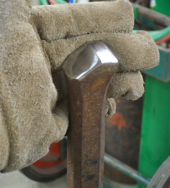

So far, everything has been done with this hammer.
For raising in under the chin, I switched to this hammer.....
...until the curve got too tight, and I had to go to something narrower. This hammer is really too narrow for the job, but my wider crosspeens are too heavy.
I cut a checking template to match my proposed profile, and use it to see what I have to push back in or flare out.
All this compression under the chin tends to make the sides of the piece spread. I restored it to shape be locking the piece up in the big vice, heating the center line to redness, and turning the handle. That's OK as far as it goes, but we really need a way to keep the sides from spreading during the really aggressive shaping. I have done this different ways, but today's idea was to make a brace of scrap steel and clamp it in place. This bevor-bondage worked better than I had hoped. I just had to remember to keep the clamps tight...Oh and to remember that the clamp handles might be hot.
Things are starting to look pretty good. There's still more shaping to do, but I don't want to get ahead of myself.
This shows a tentative fitting with the gorget lame template. Note how I clipped the edges so that the cardboard could flare.
I will probably start building that lame before I do any more work on the chin. There will be a certain amount of give and take to get all this to fit together, and I don't want any one piece to be so far allong that I am unwilling to change it if I need to.
I have overworked my left hand this week.... Another old injury that never really heals. I will try to take it easy and pick things up again on Monday.

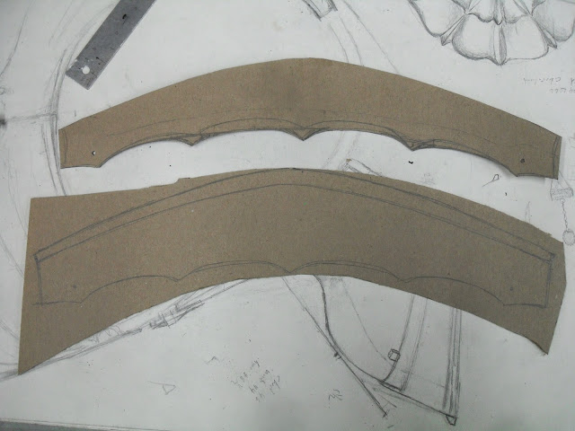

This if the bevor gorget plate template I was working with the other day. The black line on the bevor is where the template came to. The overlap is a bit much toward the back, so I cut some off the template.
I used that template to make the final one. It is important to invest a little time and cardboard in the process. This template was the forth generation.
I cut the plate out of .062" stock. The gorget plate does not need to be as thick as the body of the bevor for two reasons. First, it is mostly overlapping the breast. Second, it's location makes it unlikely to receive the full force of an attack. It's the same reason that real breastplates are thinner on the top than they are in the front.
Just bent into shape, it looks pretty "flat", but a little work with the hammer gives it some life.
When I got the two pieces begging to fit together, I found that the overlap at the sides was still too much. The black lines on the gorget plate show how much I will trim away.
....and I marked the same amount on the template. I always trim the template as soon as I trim the work.
That's better. Note that the gorget plate is provided with holes for three rivets. When it is done, the one in the front will be a fake. This will allow the chin of the bevor to "nod" a bit. Because the pivots are neither coaxial, not right at the back, there will be a springiness in the assembly that will bring the chin-plate back up.
It is temporarily riveted together. Now it is time to make the parts fit together better with a bit of local heat and a hammer.
More like this.

I mostly make up a new template when I find I need to add material. The first one gets me "in the ballpark". The next one gives me a chance to cut away what I don't need and make things symmetrical. It's an iterative process. Sometimes I hit it on the first shot, but more often than not I go through two or three generations of templates before I think it's ready for steel.

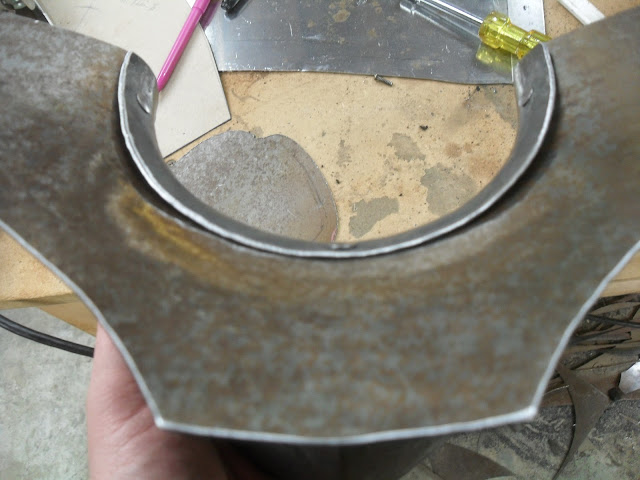

Today I messed around some more with the bevor. In this pic we can see that the profile is getting close. I still need to pull the "nose" in a bit. That would happen later in the afternoon.
The thing about that profile is that it has the neck coming in pretty tight under the chin. This won't let me carry the crest lone down on to the neck like I want to. So... I needed to boss it back out a bit.
This leaves a sort of bulge that needs to be spread back out.
Here I am starting to fix one side.
I decided that the best thing to do with the gorget plate was to get it to settle in just above the flute spray. I will hot-fit the point later. It looks like I will have to forgo the idea of replicating the edge treatment of the plackart on the edges of the gorget plate. Between the height of the finial and the presence of the the flute spray, there is precious little room to get the gorget plate lying down gracefully. There's just not enough leeway for decoration. I may be able to lay on a couple of flutes if I am careful to make them bulge above the level of the plate.
This is the second first approximation of the falling lame. The first first approximation turned out to be a bit of a tight squeeze into the helmet. I needed to make the sides of the chin plate a bit narrower, and this necessitated making the template again.
As I alluded to above, I needed to see how things interacted, so I put it all on.... sort of. One thing I learned is that I really don't have enough room for a big honkin' triangular hem at the top of the fall. It's going to have to be a small boring little hem. The other thing I learned is that it's hard to take selfies this way.
The surprising thing about sallets and bevors is how much you can see with the helmet tipped back like this. Those guys you see in the paintings with only their noses visible can actually see pretty well under the edge of the helmet.

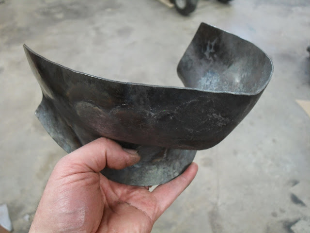

After cutting the plate out and smoothing the edges, I used a crosspeen to draw out the hem allowance a bit.
The hammer marks are on the face (as apposed to the back), so they will end up on the inside of the hem.
Roughly bent into a curve before hammering from behind.
I hammered up the crest from behind with this hammer. It's one of my favorites. Its length and small face give it a lot of authority.
Too round on either side of the crest....
...that's better.

Jason Grimes wrote:I see you put the third temp rivet in right where the hole for the lock will be, very cool. :D
Jason
Good catch. I forgot to mention that in the text.

Some people like making tools. You know who you are. I do not like making tools. My shop is cluttered with tools that don't quite do what I had hoped they would do. Nevertheless, I could see that the tools I had at my disposal were not really getting 'er done, so a had to break down and make something different.
This is ground down from one of those stakes from the Lynch clearance sales. What I needed was something that would support the lower (angled) facet of the hem while I hammered on the upper (horizontal) facet. The cut away provides hammer clearance.
After an initial (undocumented) course of squaring up the hem with a small square faced hammer, I shifted to working alternately between the vertical facet and the horizontal facet. The new tool supported the angled facet during that later mentioned process. (These pics were posed. The process actually happened hot).
The results were not at all bad. I think this tool might be one of the rare "good ones". One of the things I like about it is that the "mistake marks" are correct. Not those little hacks....I made those by applying the square faced hammer a bit too cavalierly . I mean the slight recurve where the angled faced meets the body of the plate. These happened when I failed to have the tool tucked in tightly enough. You see that same sort of thing on real hems; and that smells of authentic technique.
Overall, things look like they will grind out looking OK. I could try sharpening things up some more, but I fear that it would be at the risk of screwing things up.
I feel in general that our collective understanding of hems is in need of some brainstorming. We should have a "hem symposium", where we can all get together and demonstrate and discuss what we do. Is someone out there interested in hoisting the first "Hemcon"?
