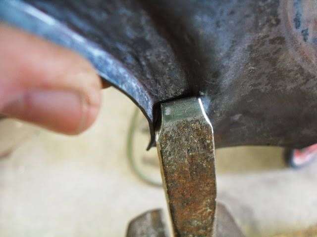

The first thing I did was to lay in the border by turning down the edge and making a "half flute".
Next, I needed a fluting tool that was narrow enough to fit within the border. I think I mentioned somewhere else that I do not like making tools. This one used to be chisel I bought at a flea market. The view here is from under the plate, with the tool in the vise.

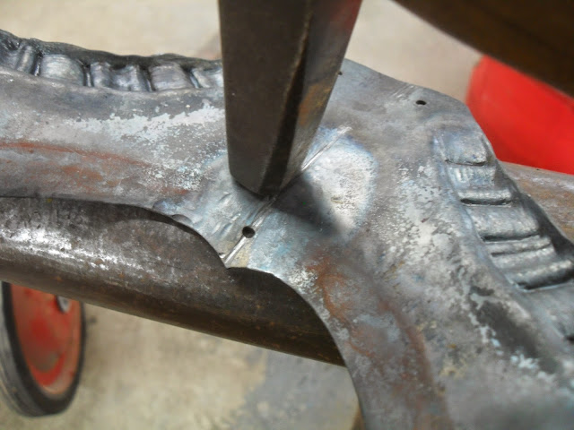

Here are the spacings marked out in soapstone, because they are going to be done hot. The "innies" are marked with a circle; just to keep track.
Here I have set the flutes, and am about to go back and depress the "innies" with a slightly wider cross pein. This will be done hot, with the work supported by the fluting stake. The stake gets shifted to whatever end on the "cell" needs support.

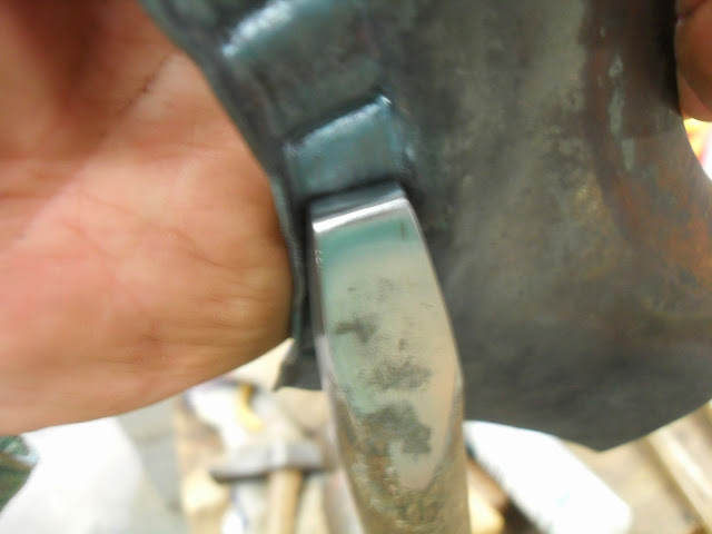

For the "outies" I needed yet another stake. This one was ground from another flea market find; this time a shank from a small air impact hammer.
Like the other, this stake must fit between the edges of the border.
With the "innies" and "outies" bossed in, the edge has come to be a bit funky.... but you all expected that, right? Before the plate is fitted back to the breast, these edges must be ground to a nice smooth line.

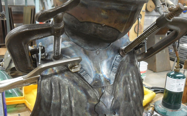

Refitting the bevor to the breast took a certain amount of heating, clamping and pressing, as well as that pair of screws in the area that will be cut off later.
This is what it looks like when I quit this afternoon. It fits pretty nicely. I have not sharpened up the crest line under the chin yet. I also need to close up some spaces to either side of the crest... they are a bit too open.
