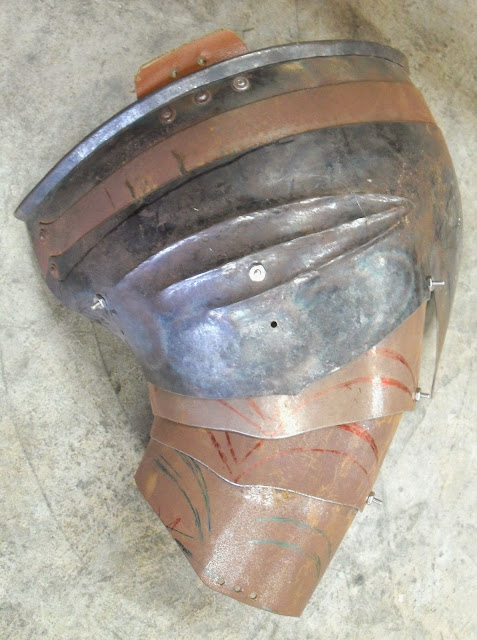

Today I refamiliarized myself with the shoulders.
Let's step back a few years. At the very first fitting session this is what the shoulder and upper arm assemblies looked like.
This is the amount that they would flex. I found it worked OK on me, but that test only works if the armorer and the customer are the same size.Image
Unfortunately, this was just not going to do it. The upper arms were too tight, and a bit too short as well. The pauldrons themselves were a bit small, but I was prepared to ignore that.
The first thing I did was to decide that the upper arm lames were essentially scrap. This freed them up to be used a templates and models. I then cut the seams apart and spread them till they had a better circumference..... Image
....and made some notes about how much needed to be added to the width of each lame to make the length of the upper arm come out right. Image
Then, while my August Patron was being a tourist in the Greater Philly Area, I built a new set of upper arms. This is, by the way, an excellent way to organize a fitting if your client is willing to be in town for a few days. You try everything you have prepared, and if something needs rebuilding, your client gets to see the sights for a day while you work frantically in solitude.
The new upper arms fit better.... but the range of motion was insufficient. And this is where we ran out of fitting time.
Several years elapse during which time ....I have a rather unsuccessful surgery on my right elbow.... and then my left elbow starts giving me the same sort of trouble....and I take it easy and try not to do anything to hurt myself... and in a couple of years my elbows start to feel a bit better but I am afraid to do anything .... and then my Patron reminds me that we are not getting any younger (which is very true)....and I start the project back up again.
In picking the project back up, we decide that as a fallback position, we would try a more conventional sort of upper arm/pauldron arrangement. You all may remember that I made new upper arms a few months ago. Well... That was a bust too. The new upper arms look nice.
....but their range of motion is even worse than the "MK II tubes within tubes" arms. And, of course, it's not what's on the statue.
Following some of the suggestions of James Arlen G., I began tweaking the articulation of the left MKII "tubes" arm, and found that I could get more out of it than I had. Image
But, this motion comes at a cost. The inside view shows how much the edges of the lames/tubes intrude on the wearer's space. Image
About that time, I tried the armor on our local body double, Galleron. The thing I learned from this is that I had the arms set too far forward on the pouldrons and there was not enough space at the front of the shoulders. I was going to need to make new pouldrons, and this would be the opportunity to make them be bigger.
These pics show the difference between the old and new pauldrons.
The plan is to make yet another set of "tubes within tubes" upper arms see if I can get them to work this time. The hope is that the additional room I am building into the fronts of the new pouldrons will give enough clearance for the whole thing to flex sufficiently.
I will begin templating them this evening and hope to be shaping steel tomorrow.

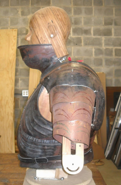

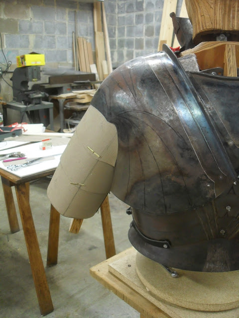

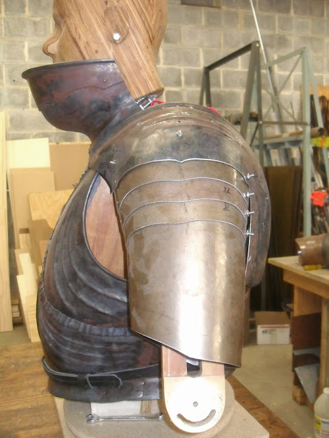

This evening I started in with the templating, the morning having been largely devoted to plotting and scheming. The old MKII templates are shown for comparison. The new templates are predicated on the idea that the ventral side of each lame will be conical, while the dorsal side will be cylindrical. That is to say, all the necessary conicalness or the assembly will be in front, where it will do the most good.
All cut out, pinned together, and wedged into place; the assembly looks like this.
It's a good first shot, but each of the lames needed a bit of tweaking one way or another. The bottom lame needed a bit less of the "conical thing" in the front, so I snipped out a wedge and taped it back together.
Also, the upper edge did not sit as flat as I wanted it.
Those changes go into the next iteration.
All the lames got replaced at least once this evening. The results are better, but I will probably come back at it tomorrow before I commit anything to steel. The blue marker lines on the main plate of the pouldron show approximately where I expect to trim it, but that will not happen till the upper arm assemblies are roughed out.

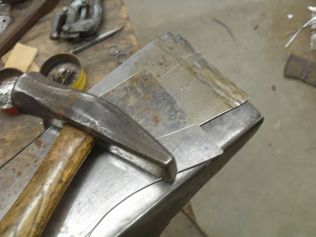

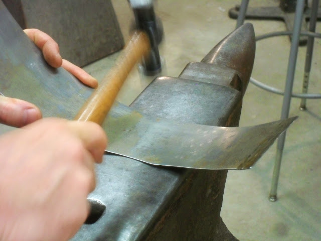

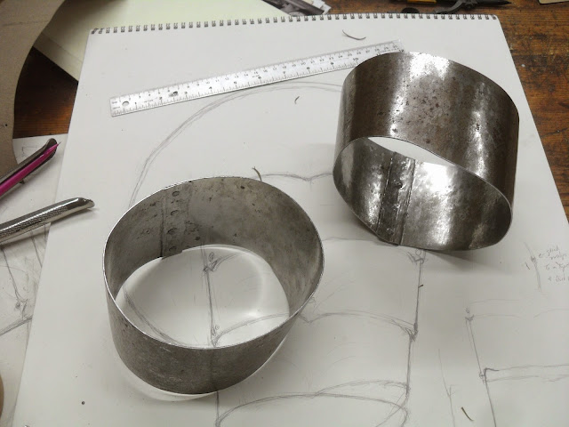

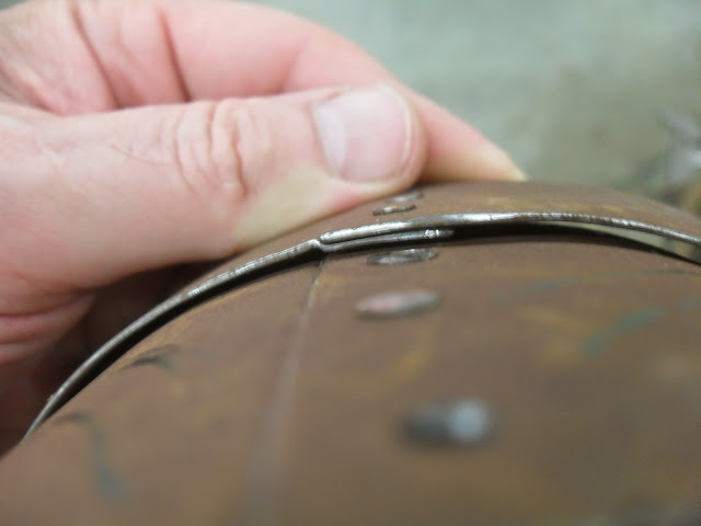

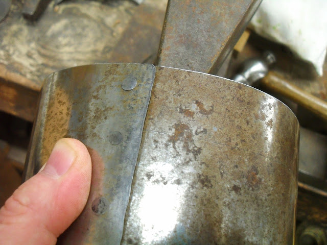

Today's work was to begin cutting and shaping the new upper arms. Here are the lowest lames all laid out on the steel.
I thought I would try something a bit different for the riveted closures of the tubes. This is what the MKIs look like. They are flush riveted and the joint is stepped down to create a smooth outer surface that will grind well.
But that's a whole thickness of metal plus the rivet heads on the inside. This makes the articulation a bit sloppy.

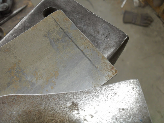

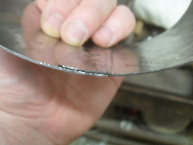

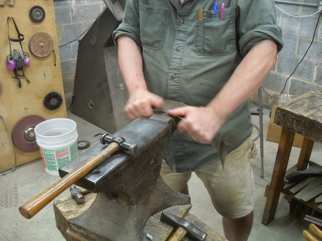

For the new parts, I thought I would try reducing the internal bulk by thinning the overlaps and using headless rivets. I drew lines on the inside surfaces to guide the thinning process....
....and crosspeaned the overlaps to thin them.

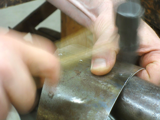

After thinning the overlaps I gave the lames a bit of a curve to "give them the idea".
That was followed with the usual hammering from the back to "give them a bit of life".

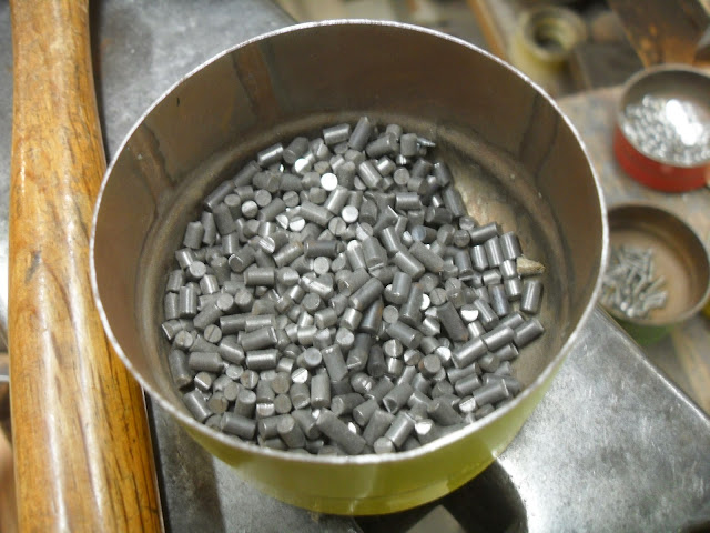

For those "headless" rivets I mentioned, I used a few of the cut-offs that I have been saving.
The ballpeen hammer is a suitable tool for this job.

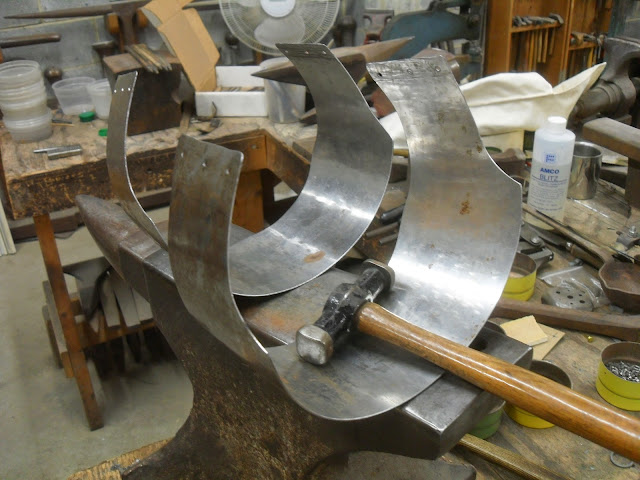

Notice that I have countersunk the holes on the inside as well as on the outside. I want them to be as smooth as possible.
Once the rivets are set, the joint is "set down" over the edge of this bicorn. I used the flat face of my favorite ballpien hammer for this.
The resulting joints are smoother on the inside than my previous ones. I hope the extra effort will have been worth it.
The lowest lames are ready for the next step.

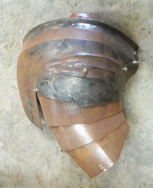

The second lame went together pretty quickly.
The cross section is very strongly oval.
The third lame was even easier, because it's open on the inside.

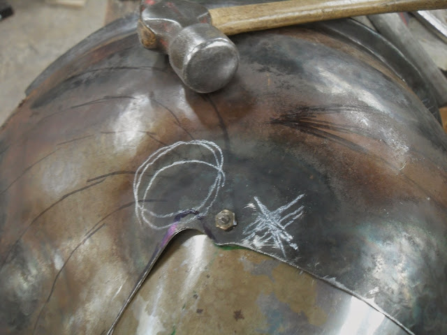

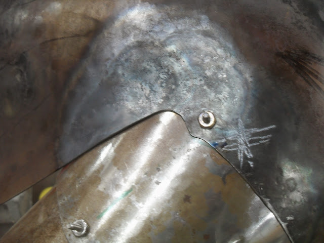

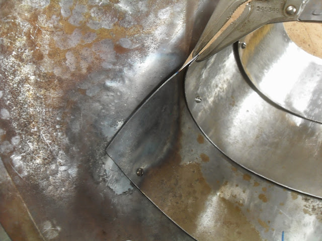

Getting the new upper arms to fit the pouldrons took a bit of time a trouble, but all in all it went more easily than I feared it would. The green lines on the upper arm lame mark the place where I would like it to line up. The rivets should all line up along vertical(ish) lines, and those are marked in as well. The distance between rivets should be 3", and the places where the vertical(ish) lines are crossed (up in the prospective underlap) is where I hope to place them. The blue dots on the pouldrons are where I will punch the holes.

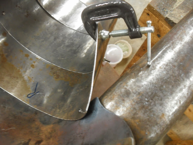

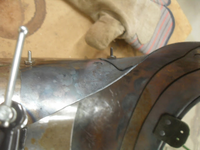

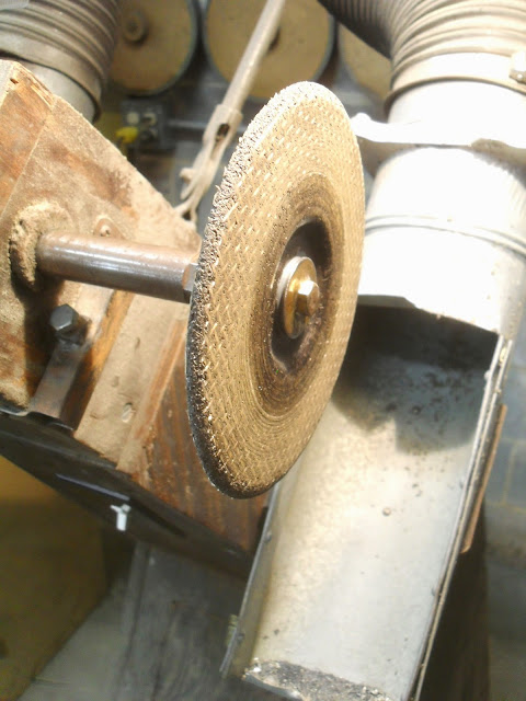

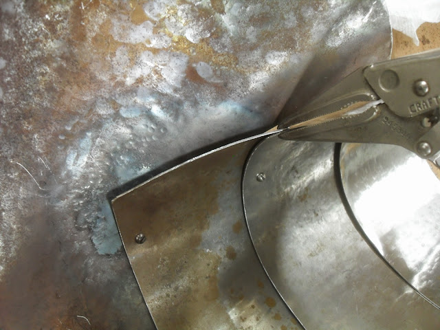

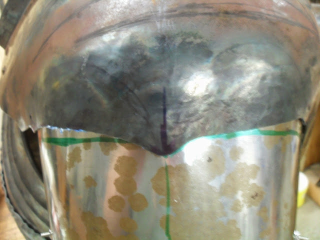

That blue line on pouldron plate is a first approximation of what I think I need to remove.
So, I grind until I get nervous, erase the line with acetone, and try to fit the parts together.
I then make a new blue line and repeat the process.
After three iterations of that, they pretty much fit, and could be bolted in place. This is not the final shape for the edge. It will get cleaned up and made pretty later. Note that the holes in the pouldron are punched already, and it was just a question of figuring our where to punch their mates in the lame.
This is where I am stopping for the day. Both arms are bolted onto their pouldrons.

the first thing I needed to do today was to get the ends of the upper lames and the main plates of the pouldrons to fit properly at the front and back.
This is the back of the right pouldron. The "X" is the place where the work will be supported, and the circle is the place that will be pushed down. This will be hot work, and the hammer I started with is the one in the pic.
I found that hammer to be a bit big, so I continued with one that has a smaller face.
Same thing for the front, except I am not going to close up the entire space by moving the pouldron plate.
Some of the gap will get closed by reshaping the lame. I have clamped the place where lames two and three come together because I don't want that to change.
After a little heating and gentle beating, it looks like this.
This would be a difficult shape to manage cold, but with heat and clamps, it's trivial.
A similar thing had to happen in the back.
This time it's the pointy vicegrips that is needed. It's important to remember to keep the torch off the vicegrips or you can ruin the spring.
Voila!
Then the whole area gets warmed up to stress relieve it.
Here is where I plan to trim the edges.
So, everything gets disassembled and taken to the grinder. I don't have any pictures of the grinding. It's boring work, and it takes longer than it has a right to . After the exposed edges were ground to shape and smoothed off, I reassembled everything and marked the places where the edges lie. Those are the thin blue lines in the next pic. The green lines are about trimming the amount of underlap.
After messing with the underlaps in the backs of each lame, I was reasonable satisfied with the motion. I will brobably make further adjustments, but here is what I get right now. I believe this is going to work OK.
The next issue is this. In the pics of the statue, it is abundantly clear that the second lame of the upper arm is a complete tube for about 2/3 of its height, and that it extends above the ham of the breastplate. I've pretty much got that, but it's not very comfortable. I am considering cutting some of the second lame away so that it ends below the hem of the breast. This will allow the arms to sit closer to the body. It won't be like the statue, but it will be more comfortable to wear. I will write my August Patron and see if he would rather have fidelity or comfort.

These underlaps at the tops of the lames got cut with an "aviation shear". The result was not very accurate but it's inside, so as long as it ends up smooth it's OK.
These points however can't really be cut with a shear. A shear can not enter the work at such a shallow angle. Grinding and or filing is really the best way here.
Here, where the pouldron plate needed trimming, I could have gotten most of the material off with a shear. I chose to use the grinder for two reasons. The one is as Sean says; the air cooled steel is abusive to the shear. The other is that I was headed for the grinder anyway.
I will post a pic of the grinder later today. It may not be what you have in mind.

Here is a pic of the grinder. It is shown with what is left of a 9" (?) "notching" wheel mounted on the arbor. These "notchers" are designed to work like big cutoff wheels. They are course gritted and very well reenforced. The skinny little edge is very aggressive. This makes them great for hogging material away. As far as dust goes, the thing at the bottom of the image is the scoop of the dust collector. That takes care of most of it.
