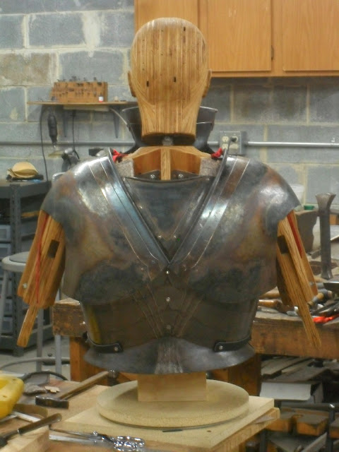

I decided it was better to risk loosing the St. Florian pose, and put the arms on the torso.
This made it easier to get the pauldrons fitting. The deep hems needed to be adjusted a bit to get the curves to match and fit the cuirasse. That was mostly done by spot heating to red and gently bending the plate.
This turn-torso thing is definitely "the bee's knee's"! While messing with the pauldrons, I must have turned it around dozens of times, and before they are done I expect to turn it a hundred more times. It was a good investment of time and money.
I could not resist putting the helmet on to see how things were looking.

Today I refamiliarized myself with the shoulders.
Let's step back a few years. At the very first fitting session this is what the shoulder and upper arm assemblies looked like.
This is the amount that they would flex. I found it worked OK on me, but that test only works if the armorer and the customer are the same size.Image
Unfortunately, this was just not going to do it. The upper arms were too tight, and a bit too short as well. The pauldrons themselves were a bit small, but I was prepared to ignore that.
The first thing I did was to decide that the upper arm lames were essentially scrap. This freed them up to be used a templates and models. I then cut the seams apart and spread them till they had a better circumference..... Image
....and made some notes about how much needed to be added to the width of each lame to make the length of the upper arm come out right. Image
Then, while my August Patron was being a tourist in the Greater Philly Area, I built a new set of upper arms. This is, by the way, an excellent way to organize a fitting if your client is willing to be in town for a few days. You try everything you have prepared, and if something needs rebuilding, your client gets to see the sights for a day while you work frantically in solitude.
The new upper arms fit better.... but the range of motion was insufficient. And this is where we ran out of fitting time.
Several years elapse during which time ....I have a rather unsuccessful surgery on my right elbow.... and then my left elbow starts giving me the same sort of trouble....and I take it easy and try not to do anything to hurt myself... and in a couple of years my elbows start to feel a bit better but I am afraid to do anything .... and then my Patron reminds me that we are not getting any younger (which is very true)....and I start the project back up again.
In picking the project back up, we decide that as a fallback position, we would try a more conventional sort of upper arm/pauldron arrangement. You all may remember that I made new upper arms a few months ago. Well... That was a bust too. The new upper arms look nice.
....but their range of motion is even worse than the "MK II tubes within tubes" arms. And, of course, it's not what's on the statue.
Following some of the suggestions of James Arlen G., I began tweaking the articulation of the left MKII "tubes" arm, and found that I could get more out of it than I had. Image
But, this motion comes at a cost. The inside view shows how much the edges of the lames/tubes intrude on the wearer's space. Image
About that time, I tried the armor on our local body double, Galleron. The thing I learned from this is that I had the arms set too far forward on the pouldrons and there was not enough space at the front of the shoulders. I was going to need to make new pouldrons, and this would be the opportunity to make them be bigger.
These pics show the difference between the old and new pauldrons.
The plan is to make yet another set of "tubes within tubes" upper arms see if I can get them to work this time. The hope is that the additional room I am building into the fronts of the new pouldrons will give enough clearance for the whole thing to flex sufficiently.
I will begin templating them this evening and hope to be shaping steel tomorrow.

This would be a difficult shape to manage cold, but with heat and clamps, it's trivial.
A similar thing had to happen in the back.
This time it's the pointy vicegrips that is needed. It's important to remember to keep the torch off the vicegrips or you can ruin the spring.
Voila!
Then the whole area gets warmed up to stress relieve it.
Here is where I plan to trim the edges.
So, everything gets disassembled and taken to the grinder. I don't have any pictures of the grinding. It's boring work, and it takes longer than it has a right to . After the exposed edges were ground to shape and smoothed off, I reassembled everything and marked the places where the edges lie. Those are the thin blue lines in the next pic. The green lines are about trimming the amount of underlap.
After messing with the underlaps in the backs of each lame, I was reasonable satisfied with the motion. I will brobably make further adjustments, but here is what I get right now. I believe this is going to work OK.
The next issue is this. In the pics of the statue, it is abundantly clear that the second lame of the upper arm is a complete tube for about 2/3 of its height, and that it extends above the ham of the breastplate. I've pretty much got that, but it's not very comfortable. I am considering cutting some of the second lame away so that it ends below the hem of the breast. This will allow the arms to sit closer to the body. It won't be like the statue, but it will be more comfortable to wear. I will write my August Patron and see if he would rather have fidelity or comfort.

Robert, why don't you just trim the edges with some scissors? Yea, they will probably distort the shape a little, but you have two references to fix it back in no time. Grinding that much metal seems like overkill to me and all that dust...
Re: Dusting off the cobwebs
Posted: Sun Sep 14, 2014 7:48 am
by Sean Powell
Nicknizh wrote:Robert, why don't you just trim the edges with some scissors? Yea, they will probably distort the shape a little, but you have two references to fix it back in no time. Grinding that much metal seems like overkill to me and all that dust...
I'll take a guess but Mac can correct me if I'm wrong. Having hot-worked the majority of this armor which is 1045 or 1050 there will be carbide nodules in the steel from 'air quenching' etc and they ruin shear blades pretty quickly. Also, Mac doesn't own a Beverly shear and when I had the privilege to work in his shop I brought my lighter weight steel back to my own basement for work with the HF shear. Also, Also for some of the lines even a shear can't take the curve the grinder needs to be used.

Nick and Sean, it's important to note that shears also distort the shape of the metal as they cut, doubly so for tight curves. I admit that I would have been tempted (given that IIRC Mac has a kiln for tempering) to anneal the pieces and use a jewelers saw to take the curves back - more time overall, but less of the time would be *my* time since the annealing would be overnight.
As a result of Mac's "influence" I have taken to using a jewelers saw to cut many of my more detailed / finer curves, since the extra time I spend on the cutting is (more than) offset by not having to hammer plates back into shape and clean up edges. This is especially true of thinner plates (like gauntlets) where I can't afford to lose a significant amount of material to grinding where a nick or scuff could just be ground off on a thicker plate.
These underlaps at the tops of the lames got cut with an "aviation shear". The result was not very accurate but it's inside, so as long as it ends up smooth it's OK.
These points however can't really be cut with a shear. A shear can not enter the work at such a shallow angle. Grinding and or filing is really the best way here.
Here, where the pouldron plate needed trimming, I could have gotten most of the material off with a shear. I chose to use the grinder for two reasons. The one is as Sean says; the air cooled steel is abusive to the shear. The other is that I was headed for the grinder anyway.
I will post a pic of the grinder later today. It may not be what you have in mind.

Here is a pic of the grinder. It is shown with what is left of a 9" (?) "notching" wheel mounted on the arbor. These "notchers" are designed to work like big cutoff wheels. They are course gritted and very well reenforced. The skinny little edge is very aggressive. This makes them great for hogging material away. As far as dust goes, the thing at the bottom of the image is the scoop of the dust collector. That takes care of most of it.
