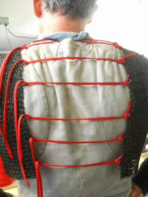

I am turning my attention to the mail sleeves. Yesterday, Will McLean (Galleron) came by to serve again as a double for my Patron. The sleeves fit OK, but I will need to make some adjustments.
The plan is to make the sleeves into a garment like this one in Berlin.
I used a bunch of nylon lace to secure the sleeves to "G".
The trick seems to be getting the tension across the back correct. If there is too much tension at the bottom, it restricts arm movement.
I used cardboard to template the "vest".
The current plan is to sew a mock up of the vest in tent canvas (because is is what I have to hand) and mount the sleeves temporarily on that. If that looks good at the next fitting with "G", I will sent that off to my Patron to try. Once I see how it fits him, I will make a nicer vest in heavy linen or hemp canvas and mount the sleeves on that.
Robert MacPherson

When you examined Wade's mail sleeves, did you look in the body portion over the shoulders for expansions? These are normal in shirts, but I didn't recall if they were in the sleeves.
Posts: 9670
Location: Jeffersonville, PA
Re: Dusting off the cobwebs
Post by Mac »
I think I see where you are headed, Ernst. I did not look specifically for expansions or contractions in the shoulder/chest parts, but I am confident that I would have seen them if there were any. After a bit ones eye just goes to these things.
So, I suppose we can conclude that they were built as sleeves right from the start, and not just cut from a habergeon.
Robert MacPherson

Mac wrote:The trick seems to be getting the tension across the back correct. If there is too much tension at the bottom, it restricts arm movement.
It seems to me that the tailoring over the shoulders is somewhat designed to alleviate this in shirts. The only difference is that you are replacing the back fabric of mail with a back fabric of cloth, but those expansions don't usually occur that far into the shirt to warrant replacement. Then again, I've never tried making separate sleeves. Before your analysis, most people presumed that left and right were interchangeable, which is also not the case.
Posts: 9670
Post by Mac »
Ernst,
As you say, I am swapping in fabric for mail. The thing where the back of this "vest" is broader than the front is pretty much what the shoulder blade expansions in a mail shirt are there to achieve.
Strangely enough, it was tension in the lower half of the thing that limited forward arm movement. That's at the very bottom of, or perhaps below where the usual shoulder blade expansions end.
When he let his arms hang at his sides, the tension was all at the top of the back near the base of the neck. (no surprise there) Bringing his arms straight forward made the upper back go slack and the lower back become tense. I suppose that if this were part of a habergeon, there would already be enough there already. In any case, it's a thing I will keep an eye out for in the future.
Robert MacPherson

Yesterday, I took a little break from the drudgerous life of the chainmail wallah to work on a project for Galleron. Being on tap a body double for armor fittings is not very exciting, so I have to keep a steady trickle of goodies headed his way.
This is the new weather vane for his tent. The ball and staff are gilt wood. The vane 6" x 8" and made of .025" brass shim stock. There is a brass disc between the staff and the vane to serve as a bearing. The rod will get replaced with a brass one, but I could not get the stock in time for his event this weekend.
