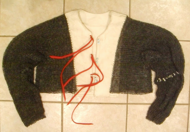

Here is the first generation mock up of the vest with the sleeves sewn onto it. The left still needs some work. The lower edge is a couple of rows shorter than the right one, and I still need to remove a bit of baggyness from the upper arm.
Tomorrow afternoon, "G" will be over to try them on. That should tell me what modifications I need to make on the MKII vest.

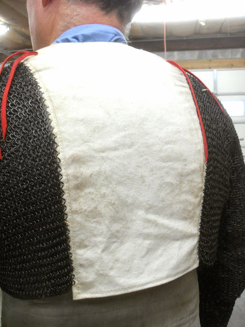

Mac,
Is that a bent metal wire loop at the top right opposite of the stitched eyelets, on the DHM original?
Looks like you put some of your pewter eyelets to good use on yours
Re: Dusting off the cobwebs
Tom,
I can't tell what's happening there. The pic is to blurry. For what it's worth, though, Dr. Luken's description suggests that the one side has eyelets and the other has "small holes where laces were probably fastened". (små hål där troligen snören/snörlåsen var fästade)
The other thing he seems to say is that the back is two thicknesses of linen. "Ryggstycket mellan ärmarna består av dubbla lager linne". I had not caught this, and just used one layer. That seemed a bit cheesy, so I put a facing in the back of the neck at the last minute. (literally... one of the sleeves was half sewn on already) Subsequent versions will have the back in two layers.
The final version will probably have stitched-in eyelets, the prototypes get pewter because its easy and fast. Dansknect may be able to sew an eyelet in 60 sec, but I sure can't! viewtopic.php?f=1&t=174573&p=2666660#p2666660 That does, by the way, show what practice can do for you. I imagine that by the time he's finished that project he will be faster yet. I wonder if he would like to sew me eyelets for me.....
Note also; the gratuitous of red cordura bootlace. I have a big old roll of that stuff, so it gets used for everything. The final version will get something nicer.
Tom B. wrote:Mac,

Yesterday's fitting with "G" went pretty well. The overall size of the vest seems good, and there are only a couple of changes I will make for the next one.
I had a bit of trouble sewing the sleeves on evenly. This is mostly because I did not mark out the stitching locations. In addition to that, the left sleeve is two rows shorter.
Here in the back, you can see some puckering in the fabric at the shoulders. That's about having the mail sewn on too "tight". I need to let the rings be a bit closer together.
The shoulders can be pointed directly to the vest. In this mock up there are only two layers of fabric there, but in the next one I will have a couple more. G likes to have the bevor on so that the pauldrons don't smack him in the throat during the "range of motion" tests. Note again: the gratuitous use of red bootlace.
The mail disappearing into the upper cannons and then reemerging at the elbow looks good.
This is about how much the forearms will be shortened by. We weighed the offcuts and found that this will be a savings of almost two pounds.
The region delineated by the six white twist-ties is what I plan to cut out and replace with more fabric. This will save weight, improve comfort and wearibility, and save another couple of pounds. I am pretty sure that this is what's going on in the Hastings MS. It's that brown area on his right upper arm.
I started in on the next prototype vest last night, and I expect to have that ready for the sleeves later today. In the mean time, I will work a bit more on the mail. There are still some bad rings to fix, and another two rows to add to the bottom of the left one.

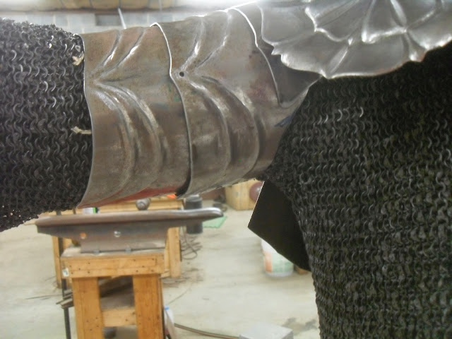

How will that effect the fit of the upper cannons? With the fabric you'll have more space but won't the forces travel across the plate and into the flesh at the edges of the maille?
It should improve the fit. The lames/tubes of these upper cannons intrude into the "living space" quite a bit when the arms are brought across the chest. Taking out a bit of unnecessary bulk should be all to the good.Ckanite wrote:How will that effect the fit of the upper cannons?
I am having trouble seeing any potential problem... Perhaps I am not understanding you. Can you say that a different way?Ckanite wrote:With the fabric you'll have more space but won't the forces travel across the plate and into the flesh at the edges of the maille?

I think the cylindrical bearing surfaces prevent such impingement. Consider the support the sides and back of the cannon will provide during that impact.Ckanite wrote:Here's what I'm thinking in as simple terms as I can think of...
OK. I think I see what you are getting at. You are concerned that the interrupted edges of the mail are themselves structures that can be driven into the body.
In general I do not think it is any trouble. For the most part, the places where the edges of the mail bear are fleshy and will not be harmed at all.
The only places where this effect might be of concern are those where bone lies directly under the skin. In this case that would be the top of the shoulder, where the end of the clavicle meets the acromion process of the scapula. That area is notoriously bony, and the pauldrons will rest heavily there. My plan is to try to end the mail above that point. One of the reasons for removing mail under the pauldrons at all is to avoid having mail impinging on the bony part of the shoulder.

Mac,
A couple of questions about your weight savings measures.
Is the estimated 4lb number per sleeve or total for both sleeves?
How much of an overlap between the mail and the plate are you planning on?
Again thanks for pioneering this for me

I am hoping to pull 2 lb. off of each sleeve; one from the forearm and another from the upper arm. I am sure of the amount from the forearm, because the offcuts have been on the scale. I am only guessing about how much the patch I plan to remove from the upper arm will weigh. I hope to know that by tomorrow, or perhaps later this evening.
Robert MacPherson
