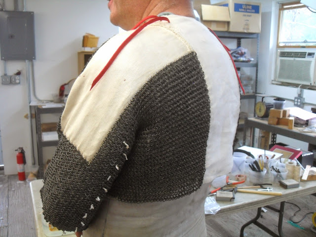

I decided yesterday to go ahead and sew the sleeves onto the MKll vest. This new one is made on a cloth called "ticken" from Wm. Booth Draper http://www.wmboothdraper.com/Hemps/hemps_index.htm It all hemp, and quite strong. It's difficult to rip across the weft, and very difficult to rip across the warp. I can not rip the warp without first notching it and then wrapping around my hands. That's a very admirable characteristic for fabric to be used in a martial garment.
The redundant mail over the shoulders and upper arms has been cut away and replaced with fabric. The savings in weight is noticeable, and it's easier to but on this way as well. You don't have to worry about the mail catching your fingernails until your arms are well in and some of the weight is already on your shoulders.
I'm not done fixing the mail yet. There's still a few hours of remedial rivet squeezing to go, but I have bruised my right hand in a couple of places with the setting tongs and need to give it a week or so to heal. The plan is to have "G" try it on tomorrow, and if everything is OK, I will box it up and send it to my Patron so he can try it on. With luck, it will fit fine, and I can finish the mail work when it comes back.

Today's fitting with "G" went well. There are a couple of things I think I need to change, but it's in the realm of fine tuning. It looks like the sleeves could be rotated down in front and up in back about two fingers width. This would involve making the next generation of vest a bit longer in front and shorter in back. The neck opening could also be a bit lower in the front center.
The test with the pauldrons and arms went smoothly enough. The only hitch was the tendency for the mail to catch on the insides of the upper cannons while putting them on. This is annoying, but not real trouble.
Coverage is good in the extremes of motion. (that white strip that we see is the pauldron leather, and not the fabric on the arm)
Likewise, everything seems good at the elbow.....
....and there are no problems in the back.
In all, I think it's time to send the mail off to have my August Patron try it on. If it fits him the same way it fits "G" then I will make those changes in the final vest. If it fits him differently, I hope to tell from the pics what changes I really do need to make.
