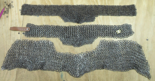

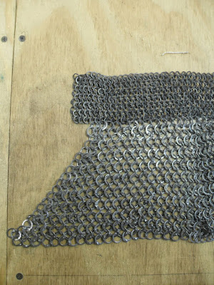

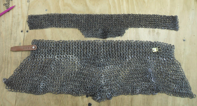

OK, I'm back at it. This winter has not been a productive one for me. Between the flu and depression, I lost quite a bit of time.
A couple of months ago, I had the idea to change the mail standard, and that's what I'm up to today. My initial construct involved two different batches of 10mm flat ring mail. The stuff I used for the collar was just a bit denser than what I used for the cape. The resulting effect was not worth the effort of having done it. Yesterday I started to replace the collar part with 6mm demi-closed fabric.
Here is the new collar sitting next to the standard. You can just barely see the difference between the two fabrics I used originally, but the 6mm should really make a better visual impression.
I cut the collar part out, and I am getting ready to knit the new collar in.
The only catch at the moment is that the row slopes do not match. After lunch I will cut one more row out of the upper edge of the cape, and that should do the trick. I hope it will not need to have another row added to the bottom to compensate. We'll see.

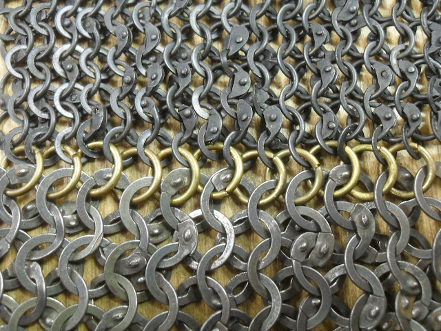

I had some trouble trying to figure out how to get the two different gauges of mail to come together, so a made up a little sample by connecting them with brass rings. It turns out that if you joining with the larger size, you need to do two with a normal four in one, and then put in one that grabs three small rings and two big ones. So... two.. two... three etc.

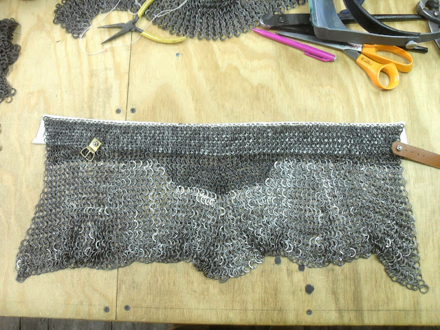

I got the new collar stitched on, but there are two issues. The first is that the new collar is a bit longer than the previous one. I knew it was, but I figured I would attache it first and than trim it. The second is that I ended up with a sort of shortfall in the cape. Perhaps the pattern I used to connect the two different gauges of mail was not the optimal one, and the cape ended up gathered a bit.
By putting in some brass rings, we can see that what's needed to extend the cape is five more columns of mail on each side.

The easiest way to make up the shortfall is to patch in a strip of mail on each side. I needed 5 more columns, so a snipped out one, and added 4. This involves a lot less ring riveting than just adding on to the diagonal edge ring by ring.
Bibimbap, and it's done.
I neglected to photograph the part where I trimmed the collar.
Mac.

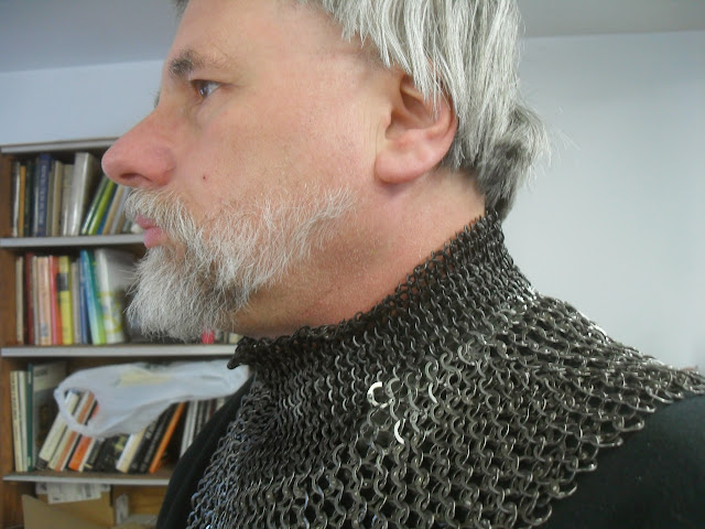

Putting the standard on, I find that the collar sags quite a bit. It's going to need a lining.
As a test, I cut out a likely sized rectangle of hemp "tickin" and hemmed it up on the sewing maching.....
....and then sewed it to the upper row of collar rings. Since it's only a test, I did not fuss with getting the size right, or even getting the ends square.
The results are very encouraging. The edge behaves its self and the collar looks pretty respectable. The white color of the test fabric does not enhance the appearance, though. For the final lining, I am thinking about wrapping a heavy fabric in red silk. That might look nice.
The back view shows where I have to be careful not to let the lining extend past the edge of the mail. It will also need a hook to keep the underlap from sagging.

Mac, that collar looks beautiful! I'm impressed with how much that small bit of fabric helped

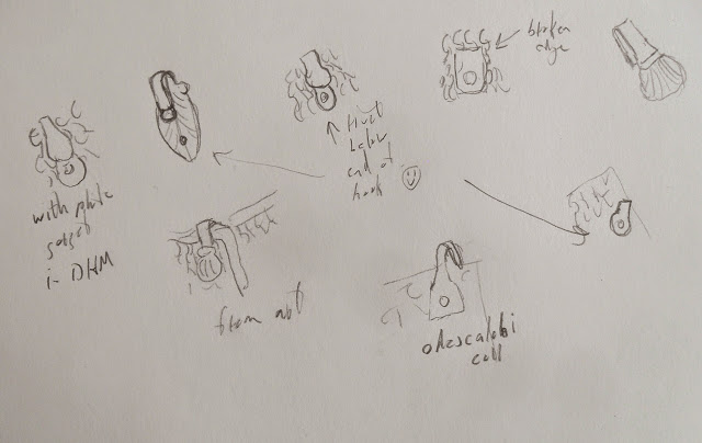

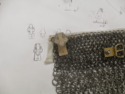

I just went through the pics of mail neck defenses in Tom B's pinterest page https://www.pinterest.com/tbiliter/medi ... nt-in-art/ looking for hooks and making little sketches and notes.
Hooks seem to come in a range of shapes, but out sample size is small, and it's hard to know what it truly typical, or what shapes might be linked to times or places. Most feature a decorative knop of some sort on the end, and that seems attractive. A couple of them are more or less sharp on the end, and that seems like trouble.
In some cases, the hook covers the mounting rivet. This allows for a shorter distance from the rivet to the bend. That's probably strong, but the rivet has to be set before the hook gets bent into its final shape. In others, the rivet is below the end of the hook. This allows the hook to be shaped before it is riveted to the mail. That seems more convenient for my purposes, since I would like to be able to remove it before I am done. In the cases of the two specimens which are broken, we can see from the distance to the upper edge of the mail that there was one of each of these types.
We have two examples of a knop in the shape of a scallop shell, and one example of a mounting plate in the form of a leaf. I like the idea of doing something fancy here, but I would like to tie it into the rest of the armor. After a bit of doodling I thought of the fleur de lis motif on the armor. In particular the pendant fleur on the ends of the demigreaves.
I realize that, historically, there is no reason to expect the plate armorer to be working with the mail maker, and that this sort of continuity of theme is a bit of a wank. But this is the only hook that anyone is likely to notice on whole armor and I want to make it pretty. I promise to make the hooks on the brayette be more boring.

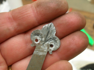

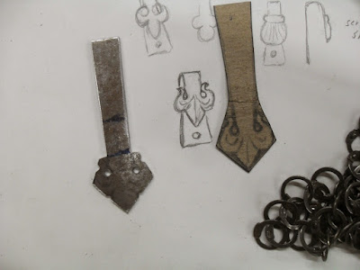

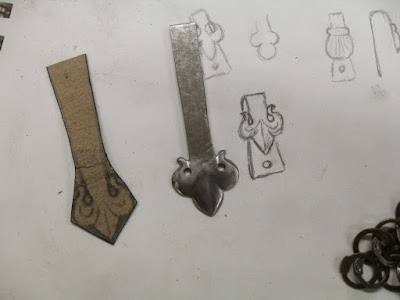

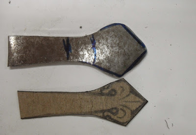

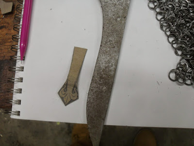

I started by cutting out a template and bending it into a hook to make sure of the length.
My first thought was to use something like 12ga., but then I found a piece of 14, and it looked plenty thick enough, so I used that. (by the time I was done, I was thinking that 16ga would have been just fine)
The area between the lines is there the bend will be, and I want that to remain the full thickness.
This shows where I have thinned the area where the fleur will be by hammering it a bit.
After the thinning, the end needed to be trimmed back to the starting size.
Some layout lines and the locations of the holes.

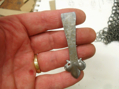

I don't have a punch in 7/64", so I had to drill the holes. Here is my newest hand vise. I have a small collection of them. This is probably the first time someone has used this tool in a half century or more.
I roughed in the shape with a Dremel cutoff wheel, and followed that with files.
It needed a bit of bossing up from the back. It turns out that my choice of thicknesses is sort of betwixt and between. It's a bit too thick to conveniently boss up without resorting to pitch and chasing tools... but it's too thin to just grind in the relief.
I filed the shank narrower so that I could thin it and spread it under the hammer.
A bit more work with needle files in the holes and then it got polished and bent into shape.. and then polished a bit more.
I made a guess about where it aught to go, and riveted it in place. Even though it's only temporary, I had to use a rivet because there's no room for a bolt. There is a washer there so I can grind the rivet away to dismount it again.
It looks like it will work fine. Marianne took this pic., so the focus and composition are better than in the selfies I took earlier today.
Before I wrapped up for the evening, I took a couple of minutes with a fine wire wheel and WD40, and made the old hand vise look a bit nicer. I hope to find a better washer for it, but this is better than nothing for now.

Would it be wrong to rivet the straps on the inside of the maille? I believe it would give a smoother appearance to the collar? The strap could perhaps even be sewn to the lining and held in place with a rivet..
Kristoffer Metsälä
Re: Dusting off the cobwebs
Nice to see you back on track, Mac. I have a question regarding the hook, does it hold the collar together just by friction?
- Keegan Ingrassia
- Posts: 6331
It keeps the underlapped edge in place, and not dropping down your neck like a shirt tag made from a cheese grater.

To add a bit to what Wade said.Jonathon Janusz wrote:Wade, thanks for the clarification.
Take a look through the standards on my Pinterest board here: Medieval Mail Collars
And these two threads:
Discussion of extant mail standards
Discussion Pizan vs Standard: what is the difference?
On the standards you can see the super dense weave on the collar and how it is different from the body / cape section.
Usually this is done by increasing the diameter of the wire the links are made from, the ring diameter can also be smaller but not necessarily. As Wade said it is most common to keep the 4 in 1 pattern but there are a few examples of 6 in 1.
Here is the most notable example of 6 in 1 on the collar, it is from the British Museum.
This is some of the finest 6mm maille I have ever seen. Too bad I can't get the person I got it from to tell me where it was made, and by whom.
and here is the SCA maille collar I made with it. Not quite as historical as yours Mac

Tom B.
- Posts: 4520
- Location: Nicholasville, KY
Mac,
An impressive bit of work, as usual!
I have been planning on make a few hooks myself but have not had a chance to yet.
Your step by step photos and explanations have undoubtably saved me some frustration.
I plan to try both the scallop shell and the leaf examples.
I at least need to doll up my personal mail pieces and make some photo essays to provide to the guys I am makeing stuff for.
If my sample hooks go well then maybe I can add them to my offerings
As always I do have a question:
It looks like you have chosen the overlap direction to be the opposite of the majority of our slim extant samples.
It looks like most of them have the buckle and hook on the wearers left.
Obviously you have not permanently attached anything yet so it could easily be changed.
