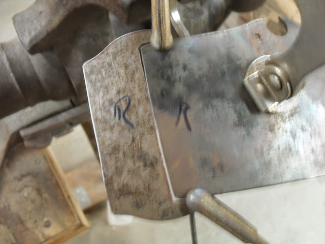

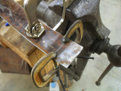

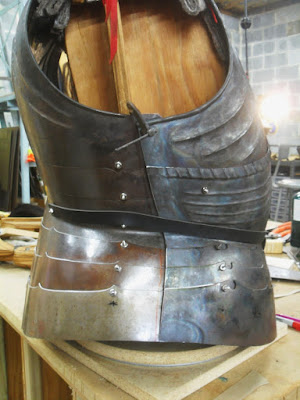

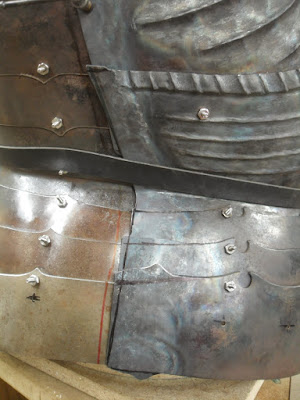

For fauld lame one, I cut out rectangular add-ons that were about the same width as the lame. There was some trouble with cooling cracks, but I eventually got them pretty sound.
For the second lame, I cut add-ons that were a bit wider than the lame in an effort to make the ends of the weld a bit less less prone to notching. I figured the additional thermal mass at the ends of the weld would help to keep me from overheating things. Well..... that part worked OK, but the resulting "step" produced a stresss concentration, and they cracked with wild abandon. I spent a certain amount of time filling the cracks, but to no avail. I figured the best thing to do was to cut off all the overheated and cracked stuff and weld on a larger piece.
The red marker shows the area that had gone all cancerous. By this time, I had ground away the troublesome "step".
This is what those guys looked like when I bent them to 90 degrees in the vise. The one might have survived the rest of the manufacturing process, but the other is pretty nasty. The less said about these the better.
Cut one off and weld the other on, and "Bob's yer uncle". Or so I thought.
Indeed, I was so confident that I took a pic of the filler "rod" manufacturing process.
I eventually got them welded satisfactorily.
For the third lame I had a "cunning plan". I figured that what I needed was for the add-on to overlap the lame a bit, so as to not have a weld running straight out to the edge.
I still ran into trouble. But, this time I was sure it was not the weld as such that was failing.
I subsequently adopted a plan of doing the ends of the welds first, and then heating the adjacent areas so that the weld and any area that seemed subject to tension would cool first. That was not a "cure all", but it was a step in the right direction.
Here is what I have now. The black lines are where I plan to trim. There is almost enough overlap, but I should really add about the same amount of material to the backplate and cullet. Some further welding experiments on strap are called for before I try that.
Image Image

I have not done any experiments yet, but I have been thinking. This sort of cracking is new to me, but I can't recall the last time I welded extra material onto a lame like this. I think the problem something to do with the shape.
I made up a little sketch that illustrates what is happening. We begin with a lame, and that lame is curved in two directions. It's curved along its length, and it is also curved a bit across its width. The add-on is curved to match. In the bottom sketch, the add-on has been tack welded in place, and it lines up nicely with the "flow" of the lame.
The upper sketch shows what it ends up looking like after I have run the weld. The add-on is bent distinctly up at the line of the weld. The amount of bend has been exaggerated in the sketch to make is easy to see and think about.
Now... if we were to take an unwelded lame and try to bend it into that shape, we can all agree that there would be tension along the line of the bend where it reaches the edges. Since my welds are cracking from the edges, I think that this must be the mechanism. As the middle of the lame cools and the metal shrinks, it forces the lame into the shape of the upper sketch, and this causes the (still soft and weak) metal of the weld to seperate in tension. The bending is being driven by shrinking metal in the middle of the lame. This throws the edges into tension as well, and somewhere in between must be a sort of "hinge" in compression. The cracks begin at the edges and propagate inward toward that area of compression until the reach a point where the tension is no longer greater than the metal's strength.
It now remains to devise a procedure that allows us to weld the add-ons without putting the edges into tension. My first thought is to begin by flattening the end of the lame before attempting the weld. If that is successful, the curvature can be restored and continued through the add-on once the weld is cleaned up.

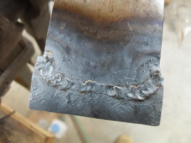

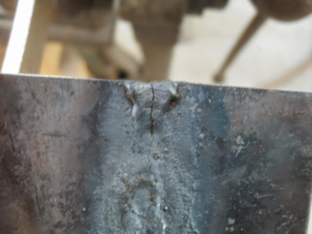

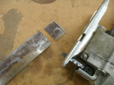

Time for a little experiment.
I made up a "lame" out of the same .059" 1050 stock by just cutting out a rectangular strip and hammering it up a bit from the back.
Then, I cut off a piece about as big as my troublesome ad-ons, and welded it right back on again.
Image Image
This resulted in the all too familiar crack, as well as a bit of the characteristic back bend.
Image Image
So far, everything is good. I have reproduced the problem under experimental conditions. If the weld had failed to crack, I would be forced to look to the Supernatural for the source of the trouble.

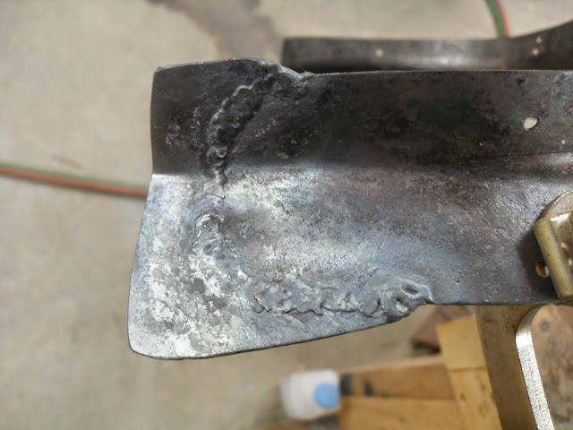

So... for my next test, I cut off another piece and flattened both of the ends that were going to be welded back together.
Image Image
Unfortunately, that did not fix the problem. It still cracked.
In both cases, however, it was the first edge to be welded that cracked. The second end appears to have survived the cooling intact. My recollection of yesterday's failures is also that it was the first edge that was more likely to crack. I also see that the cracks extend much farther than my original theory would predict. So, now we are back to the idea of controlling the cooling conditions. A quick google search for 1050 weldability is bringing up all sorts of admonitions about pre and post weld heating. I guess I've got to try that and see what sorts of results I get.
As I said before, this is pretty vexing. When I weld helmet parts together for a "can" construction, there is no trouble. Likewise, welding the cuffs onto hourglass gauntlets is always successful. This cuirasse has to be ready to try back on in seven days, and I haven't got time to fail.

I got a bit of edge trimming done this morning before running off to a Doctor's appointment. These things can really chew a hole in your day.
The first trim was intentionally a bit conservative, and I've made some lines on the upper edges of the fauld that need further trimming. We are looking for graceful sweeps here.

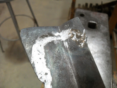

I just did two little experiments. The first one demonstrates that the nature of the filler rod is not the trouble. I ran five "welds" across this plate, using no filler at all. I let things cool in between "welds". I started at one edge and went right across to the other. There was no pre or post heating. This was intended to produce "worst case" results, and I was not disappointed.
Three of the "welds" cracked badly. The one that was about 3/4" from the edge only cracked at the end. The one that was about 3/8" from the edge did not crack at all.
So... it's not about the rod.
But that leads us to wonder about the last case, where there was no cracking at all.
I am presuming that in this last case, there is not enough material outboard of the weld to put up a fight. That material ends up heated to nearly welding temperature, and cools at about the same time as the weld. If the weld needs to suck in some more material, it just takes it from the narrow band of still hot material. That material gets deformed, but the amount is so small as to be inconsequential. This is consistent with my experience earlier, where the narrower add-ons for the breastplate welded without much trouble.
The other experiment involved a different shape for the add-on. I figured that the narrowness of the ends of this add-on would partake of the nature of the last "weld" in the other test plate. That is to say, if it's narrow enough, it's not strong enough to crack the weld.
This worked, but it was difficult to control the weld puddle at the edges. I used no post-heating in this weld, but just went from the center to the edges, and repeated that on the other side.

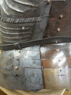

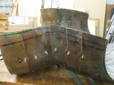

The sides of the backplate and cullet are all covered with lines. Here's the code. The red lines represent where the parts came together six (?) years ago. They have been touched up recently. The green lines represent how far the cuirasse would close last week. The black line is where the newly added to breast and fauld come to on the back when in the same position as it was last week. That is to say, the difference between the green and black lines is the stuff I just welded on.
As it stands, there is almost enough overlap to go with, but I really want to increase that overlap a bit by adding to the back and cullet. More overlap will make the armor easier to put on, and will serve as a bit of a hedge against further weight gain.
Image Image

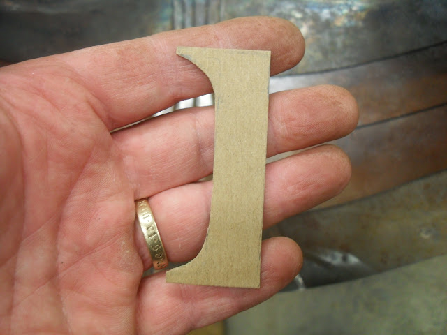

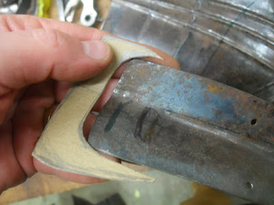

Using my conclusions from the welding experiments, I decided to use a rounded add-on form the waist lame.
Image Image
Clamped up...
...and welded. This is not a pretty weld, but it is sound and it will clean up OK...

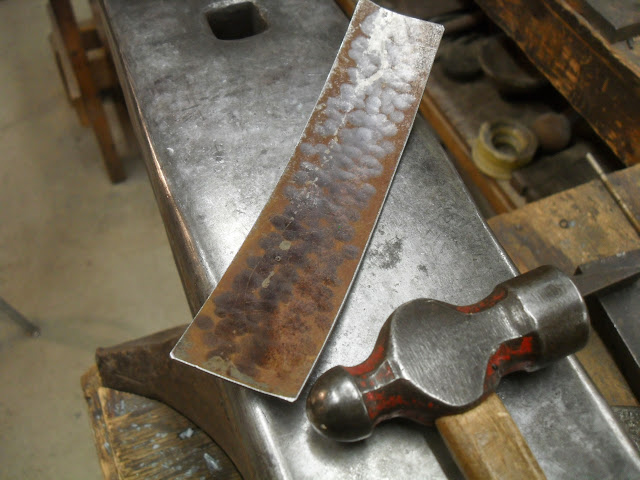

...with some grinding and hot hammering. Those low areas you can see in the upper part get picked out from behind, and driven up to match the front surface.
Image Image

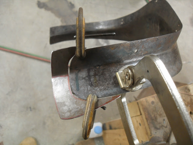

This is the general shape I have settled on for the add-ons, and it is working well.
Here's the third fauld lame with one of the add-ons clamped.......and tacked. Note the one of the tack welds has failed. This is why it is important to always remelt your tacks when you run the weld.

I weld from the center to an edge. When I reach the edge, I play the flame over the outboard material a bit until it is noticeably hotter than the weld before moving on the the other half of the weld or taking the flame away.
On the back side, I mark out a path in welder's chalk so I can see where I am supposed to be. If everything went well in the front side weld, there is little to do here except to flow it out smooth. I keep the filler rod ready, though, in case things get too hot and I need to cool the puddle, which happened a couple of times here.
Image Image
When I packed it in this evening I had all three cullet lames done, and one of the back lames as well.
Tomorrow I will get the rest of the back added to and then make things working well enough for a fitting on Saturday.
