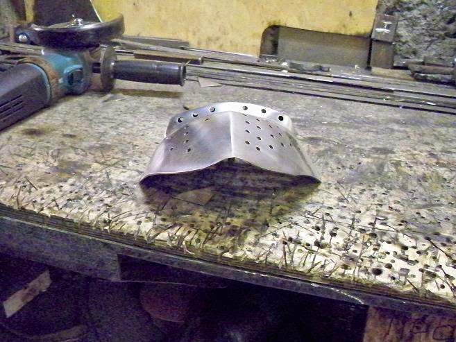

took photos of my first visor other than nasals))
Re: My work. Helmets. Can/house construction
Posted: Sat Apr 25, 2015 2:20 am
by Barbanegra
squished in the center and raised in the edges
