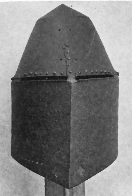

I tried to make a sort of copy of this Great Helm.
I do not have all the nescessary tools yet, and am lacking detailled information.
I layed some emphasis on getting the shape of the helm right.
I changed the nasal, because something went wrong.
I give you a picture.
I will make an other helm later.
Can someone give me information of the lining of this helm,
what it looked like. May there was no lining at all.
Thanks for your help.
Ron

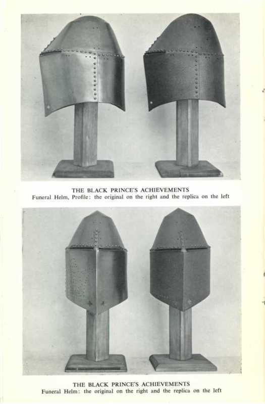

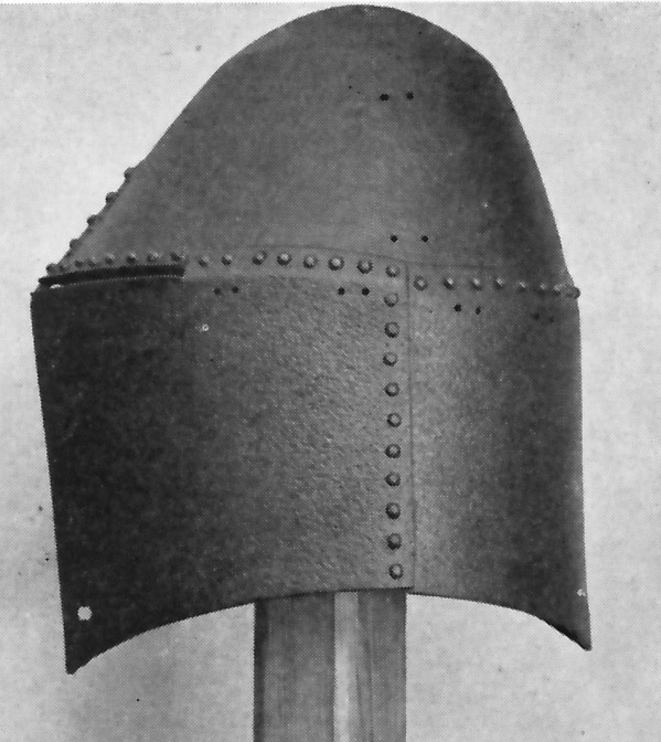

Here are the pictures of the helmet you are trying to replicate:
And it along with a replica:
What most people do is a padded coif, usually with a maille hood over it. Some make a cervelliere to go under it. My knowledge of these early items is very limited so others will hopefully provide you with more detailed and correct information.

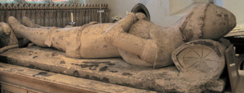

Ron, the images that Ernst showed you are all depictions of a leather suspension system. Those are flaps that are attached around the brow, then tied together at the peak.

On several of the surviving great helms traces of leather under washers on the horizontal rivets that hold the helm together. A suspension liner of triangular tabs was either riveted directly to the inside of the helm, or such a liner was sewn to a band or leather which was riveted to the helm. In either case, the rivets over the eye slots are there to hold the lining as well.
We don't know whether this lining was padded of not. Since the great helm was typically worn over a small bascinet, padding in the great helms liner is not strictly necessary. On the other hand, a padded liner is probably quieter, and would hold the helm more steadily on the bascinet. I have made one or two unpadded liners, and found that the helm tended to clatter about a bit. If I were to make another, I would try a padded one.
Note that due to the limitations of the sculpture, some of the effigies show this lining attached closer to the bottom of the helm than it would have been.
