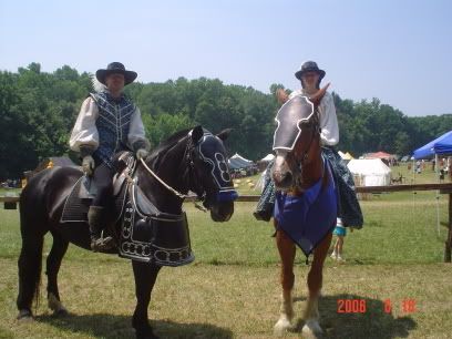

I didn't manage to get any pictures this weekend as we were pretty rushed getting everything together and of course forgot the camera. I plan to adorn my horse with this peytral for the queens joust for the rest of the run of the Va ren fair. If you are in the area please come down check it out and say hi.
Someone did get a picture of my wife preparing to joust and it is up on the VA site.
http://varf.org/gallery/2006-Season/P5200478

Here's a pic of Athena with her Peytral and Chanfron and Pheobe with her Chanfron from House of the Wolf.
[/img]
[/img]
