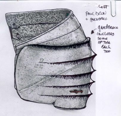

The same with the left pauldron on this armour, you can interpret it in many ways. Looking at most italian armour, I interpreted it as a variation on the italian gardbrace theme with fluting, like this:
Certain sculptural effigies, mostly strictly English styles not Italian export, pretty conclusively show applied borders, often with figured decoration and probably originally latten, but I don't think you can say the same for the two dimensional brasses you are working from. It's risky assuming that those lines -conclusively- indicated applied borders. They could just as easily be incised lines, sunken borders, or the selectively gilded borders I mentioned earlier.
That's what I wanted to know. My vision's got a bit blurred, because before speaking with Toby, I thought this was a style of english armour and interpreted it as one. And he didn't comment on the edges, I'll point that out below.
