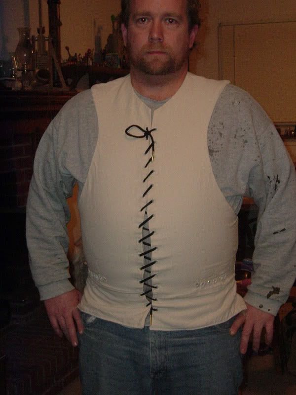

Yup, I made just what Conal has.
Steve

Konstantin the Red wrote:Well, Conal, it's a very useful pic, it is... and your photog really should have had you assume a more comfortable expression. :wink:
How's this?

Baron Conal,
could you share the construction method (double layered? lined? material) and who made the patter/mock up for you?
Thanks,
Christian Darmody
Posted: Fri May 23, 2008 7:10 am
by Baron Conal
Darmody wrote:Baron Conal,
Thanks,
Christian Darmody
If you are asking about the pourpoint....
Two layers of cotton canvas. Next one will probably be linen
canvas, we were working out the pattern... this is version
two. MUCH better than #1
We used the 'push an awl trough to spread the fibers instead of
cutting holes for the points' technique suggested by Historic Enterprises
( I think it was them ) The first one we did not and the points ripped
thru in short order...
