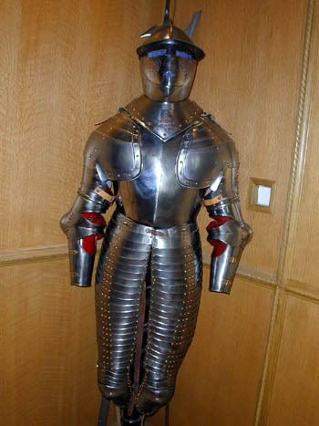

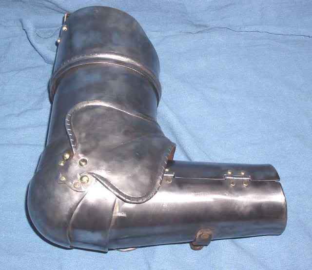

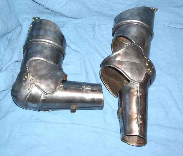

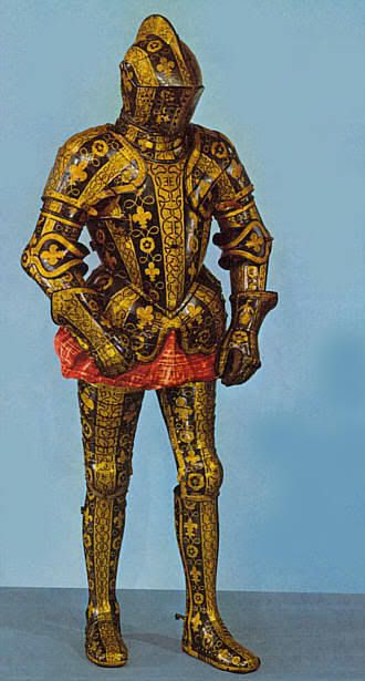

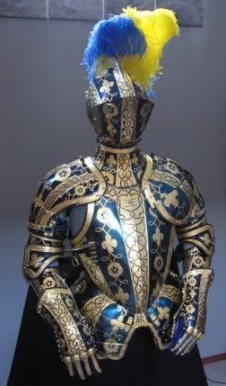

here is what the armourer makes.
here is a different style fan [img]http://i17.photobucket.com/albums/b77/AMizener/Armour/Plate87-Black-and-WhiteThree-Quarte.png[/img]
- sha-ul
- Posts: 10636
- Joined: Sat Sep 09, 2006 4:16 pm
- Location: barony of vatavia,calontir, west of Wichita

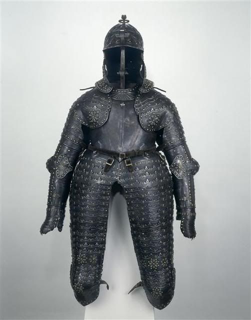

this style is pretty common for late period armour there may slight variation, but it remains pretty consistant

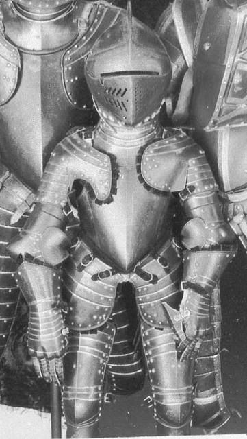

this is one of Wade Allens
they even come in different sizes

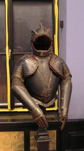

that being said this is another type of arm defense I have thought about.
all these images& about 700 more here
