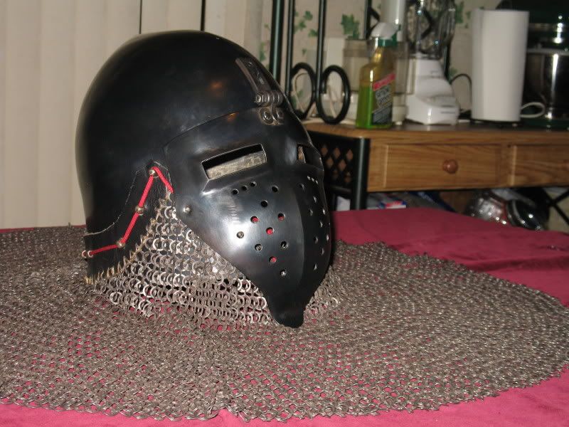

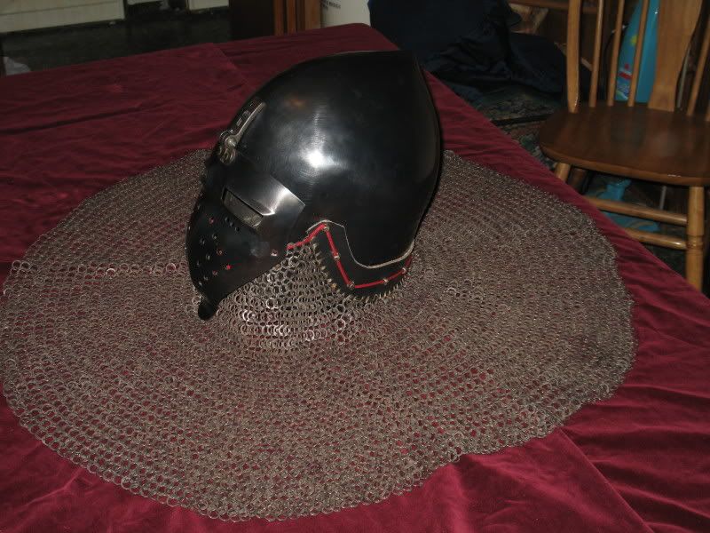

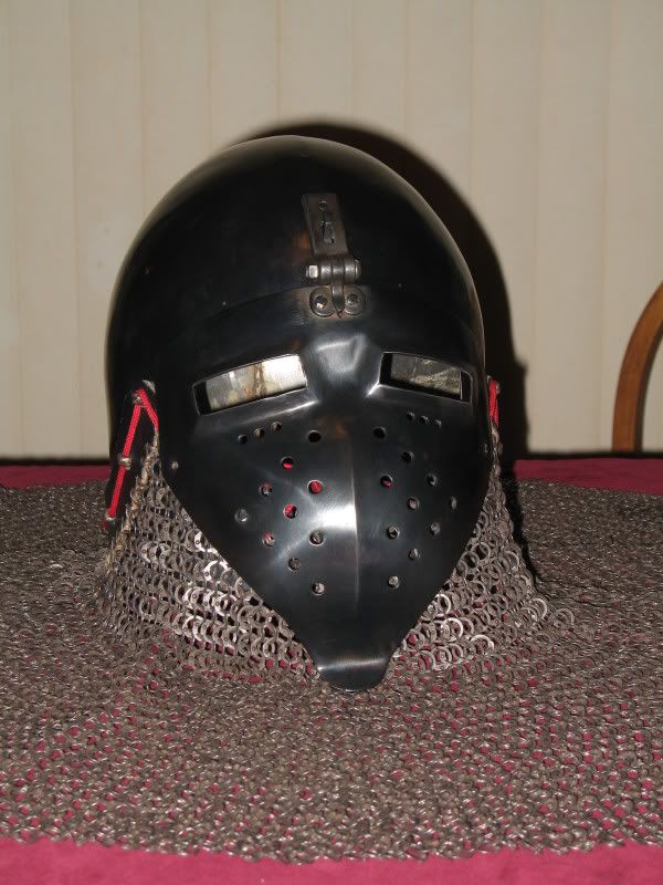

I have use it as well with great results but for best results you really need to acid clean the stainless first. For helms I dip them in a Home depot orange bucket with a 20% solution of Muriatic acid, hose off, dry, and then apply the blackening solution.
this is what you end up with
This is a reconditioned Lewis Moore Helm, And it is for sale or trade if anyone is interested. I am looking for a early 1320's helm
