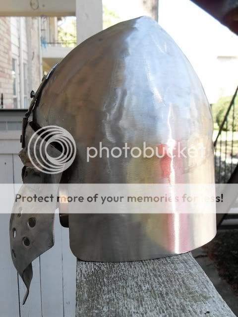

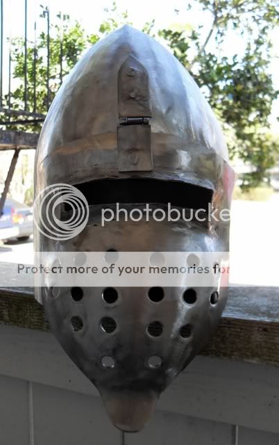

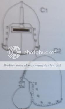

So, I just bought a stainless klapvisor from hjalmr. He custom made it to look like this drawing taken from the Osprey book Medieval Polish Armies 966-1500.
So now I want to get it cleaned up a bit. I don't want a mirror or high polish finish, but I do want to get rid of the fresh from the angle grinder look. What is the best way to accomplish this? I though about sanding it smooth, but I don't think that will get deep enough around the eye slot in the visor. Suggestions are appreciated.

Do you have any planishing stakes and polished hammers?
Hand wet sanding will go a long way.
Bring your lunch and cold beverage of choice.
Because this will take all day.
Happy Metal Pounding

No, I don't have any specialty armoring tools, just your average everyday fix things around the house tool box.
I figured it would take all day, but I wanted to make sure it was going to make a difference before I spent all day sanding something just to realize I should have used a wire brush or grinder in the first place. What exactly do you mean by wet-sanding?
