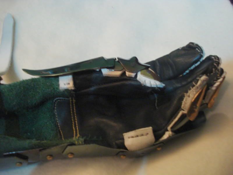

Well, not having the time to wait for reassurance, I just went ahead and re strapped the mitts I was working on.
As you can see they have fingers so half the decision was made- (I HAD to sew them to get them to work right), there is a strap and buckle at the cuff (just like the original one has in Leeds) and so that just left the palm (and a small tab at the base of the thumb).
I'll let you know how effective they are when my customer has used them in combat, they are very comfortable and feel great without the usual strip of leather running across the palm!
