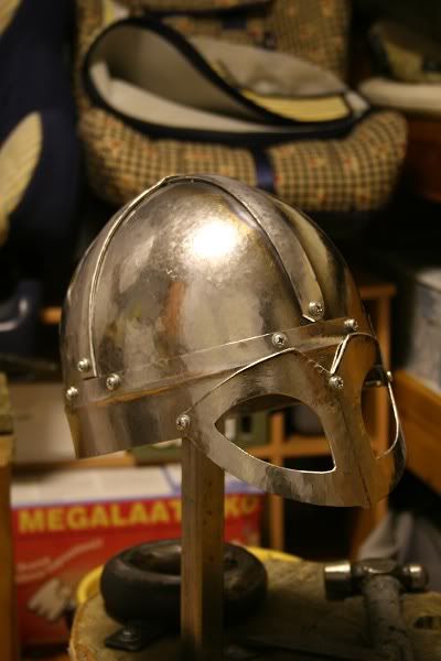

Here's my next helme in progress. Gjermundbu inspired viking helmet. 2,5mm mild steel bowl, slats and oculars and the rest will be 2mm.

Did some progress with the viking helmet. It will be a Re-enactment helm, so no grills or such. It will be blued/blackened and it shall have some brass and riveted mail neck drape.

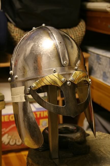

Question, did you do the Gjermunbu construction like the original with the under plate strips? [It sure looks like it.] if you did, is that method of construction easier? or harder than a normal riveted style of Spangen helm?

The heat discoloration along the central band suggests a 2 piece welded skull with the spangen bands riveted on.

SyrTheo wrote:Question, did you do the Gjermunbu construction like the original with the under plate strips? [It sure looks like it.] if you did, is that method of construction easier? or harder than a normal riveted style of Spangen helm?
Just as Mattmaus said, two piece welded contruction and the bands are for looks. Now when I think about it, it would have been easy to just split those two halves and make a riveted style. But it might not be as strong construction as now.

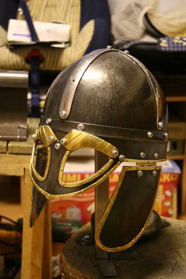

I finished the eyebrows and experimented with cold blueing liquid called Super-sini (Super-blue). I think it came out quite nicely. Not completely even surface but I think it is better this way. The whole helmet will be blued.

Hi Gp, I really like the brass detail on the helm, How did you do the lines on the eyebrows? It looks great. Thanks for the pics I love following this thread.

Post by Ghostpig »
Thank you all!
Andy,
First groove was made with a triangular needle file. Then I filed them with a square needle file to get them somewhat deeper and wider. Finally I used a sharpie to get some ink on the bottom of the grooves. All the excess ink was cleaned with steel wool.

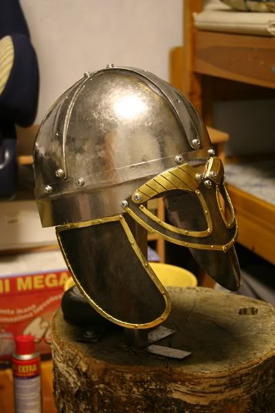

Here's a new pic of the Gjermundbu.
Brass borders are 3mm flattened wire.

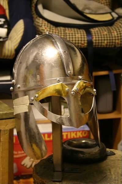

Update...
It's near but not quite yet.
