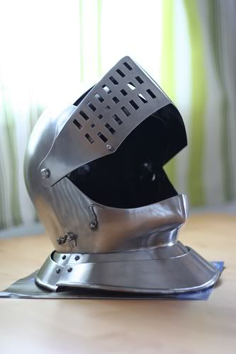

New helmet in progress. A close helmet for sca fighting.
2,5mm mild for helves, visor and the other face piece will be 2mm and the rest bits 1,5mm.

This will be something between the pattern archive close helmet and Illusion armory one and my own touch. Not a copy but a mix of things.

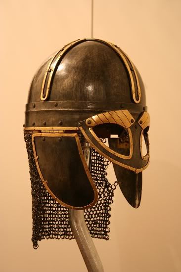

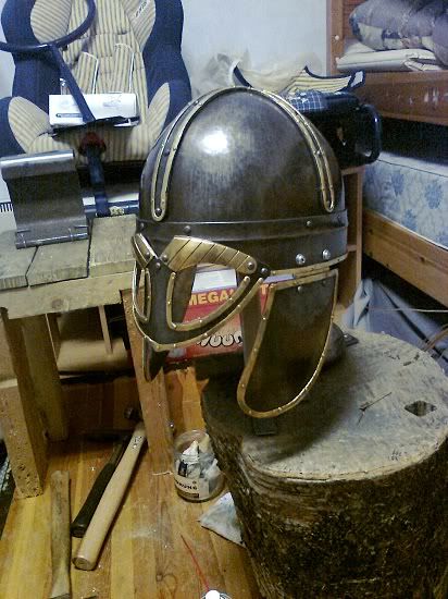

How did you patina the Coppergate?

Hal, I used gun bluing liquid. Brushed it on, let it rust and then some steel wool. Repeat 4 times and finally oiled it.
