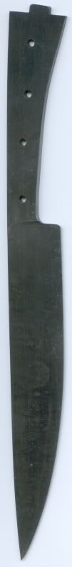

If I were to go to a butcher and ask for a bone
that I could then use to put bone plates on the
handle of a knife ( full tang ) what bones should
I be asking for to get the best yield of usable bone
from?
this specific knife....
